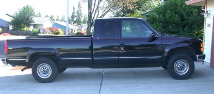

I use a Chevy 4x4 long bed with a 350 and am sick of only getting 13 mpg loaded or not! Not to mention 11.5 in town!!!

Wow, thanks for your input-I really appreciate it! That is exactly what I needed to know....Now I have to decide whether I'm too upside down in my current vehicle to pull it off-I dumped over $2000 after I bought it upgrades and repairs!!!
