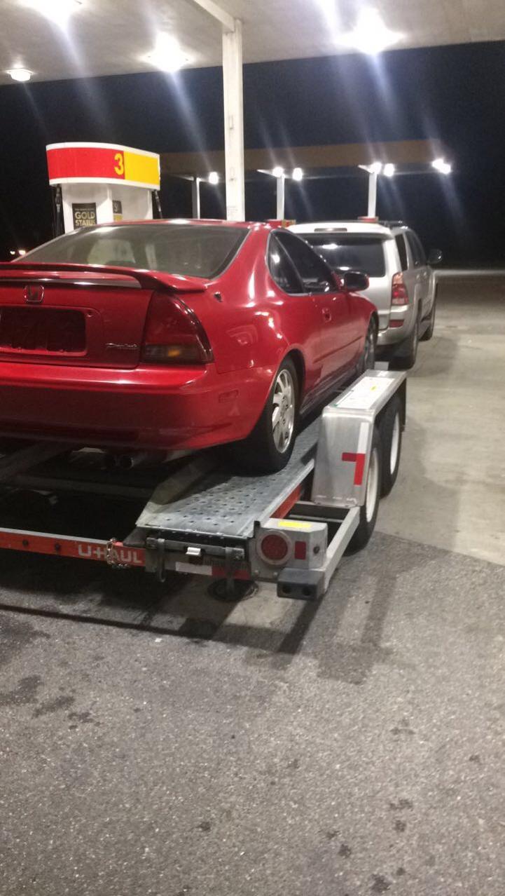

Appreciate the inputs guys. Drove 850 miles to FL. Car was ready for me to go pick up. Went to U Haul, the guy went check out my 4R to see if the lights work and checked the specs to rent a Full Auto Transport Trailer. Declined me because my receiver hitch was rated at 3,000lbs. Declined me for a car dolly too. My 4R was a red flag in their site as well. Didn't know what to do. So I went to another U Haul place, I told him it was a Tundra. This guy gave me papers to fill out and paid for it before going to check my car out.He also gave me the Full Auto Transport for the price of the car dolly. He went outside and check on it and said, "This is not a Tundra, oh wells, Merry Christmas." Lol. Luckily I was able to get a trailer. Hauled the car with ease, but tranny was smelly. 42 Psi had made the ride swerve a bit. So I aired it up to 55 PSI and made the towing smooth.

Let me get this straight.... So you not only exceeded the maximum tow rating of the vehicle, but when you brought it to Uhaul, they told you that your hitch was only rated to 3000lbs. So instead of taking their advice and not pulling it yourself and exceeding the weight limit of your hitch by over 2000lbs, you go to another Uhaul and lie and say you have a Tundra to get them to rent it to you? And then you drove 850 miles like that? Vehicle tow ratings are there for a reason, and hitch ratings are also there for a HUGE reason. This might be the textbook definition of reckless driving.
