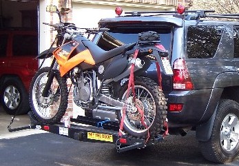

I don't tow but do haul the KTM so thats 350lb of toung wt? The rack just hangs off. As for wireing - I got an adaptor for the circular plug so the more common flat connector fits. Perhaps others that tow can add some input? I know the topic has hashed over.
