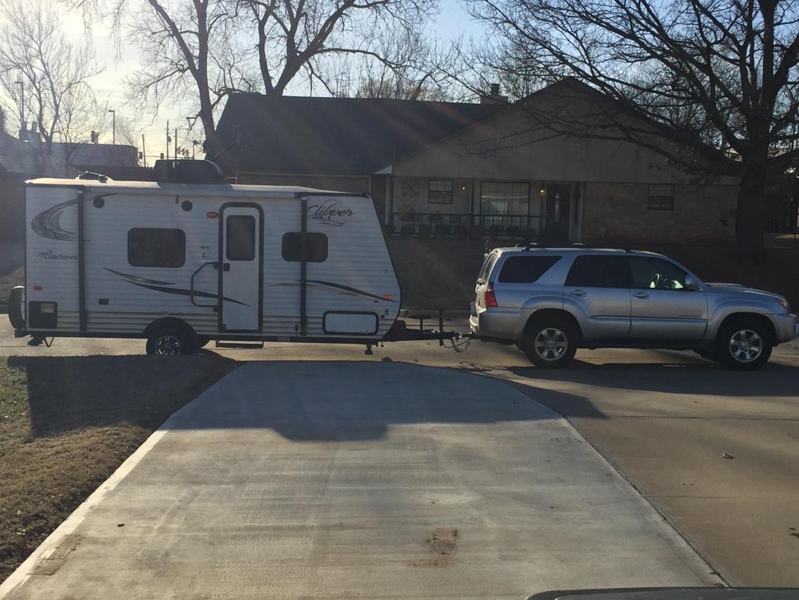

Anyone towing with the XREAS system? I have a 2006 V8 Sport. Just sold our 2016 Coachmen Clipper 17FQ and only delivered it a few miles behind the Sport so I have no real towing experience with it.. I had a 2016 F-250 with the 6.7L diesel when we bought the camper so I did not buy any kind of Weight Distribution or AntiSway hitch as the F-250 never even knew the trailer was there. No matter the wind or hills or anything.. We sold the 17FQ in hopes of upgrading to a new Aspen Trail 25BH or 2710BH but would like to know about towing with the XREAS system. I purchased new suspension off a 2017 Tacoma Sport so I have the front and rear shocks I could put on if the XREAS is not good with towing.. Also will have to invest in a weight distribution hitch with Anit-Sway I'm sure...
