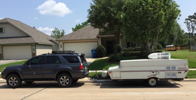

My '08 V6 pulls a 19' pop up (around 3,000 lbs loaded) with no problem. My mpg sucks while towing but that's normal. I don't have trailer brakes so I just keep alert and aware so not to have to jam on the brakes at any time and risk getting squirrelly!

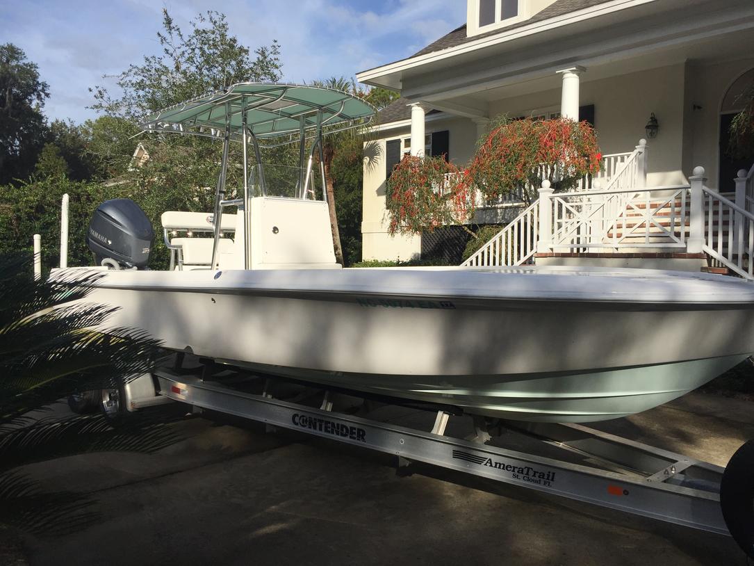

I tow my 25 foot bay boat (Contender 25 Bay) and with 80 gallons of fuel , trailer etc . it is likely about 5000 lbs. + and I have no issues, although I live in an extremely flat part of the country. The V8 actually pulls my boat well, significantly better than a buddy's 2008 5.3 liter Tahoe I had borrowed before I had my 4Runner.m

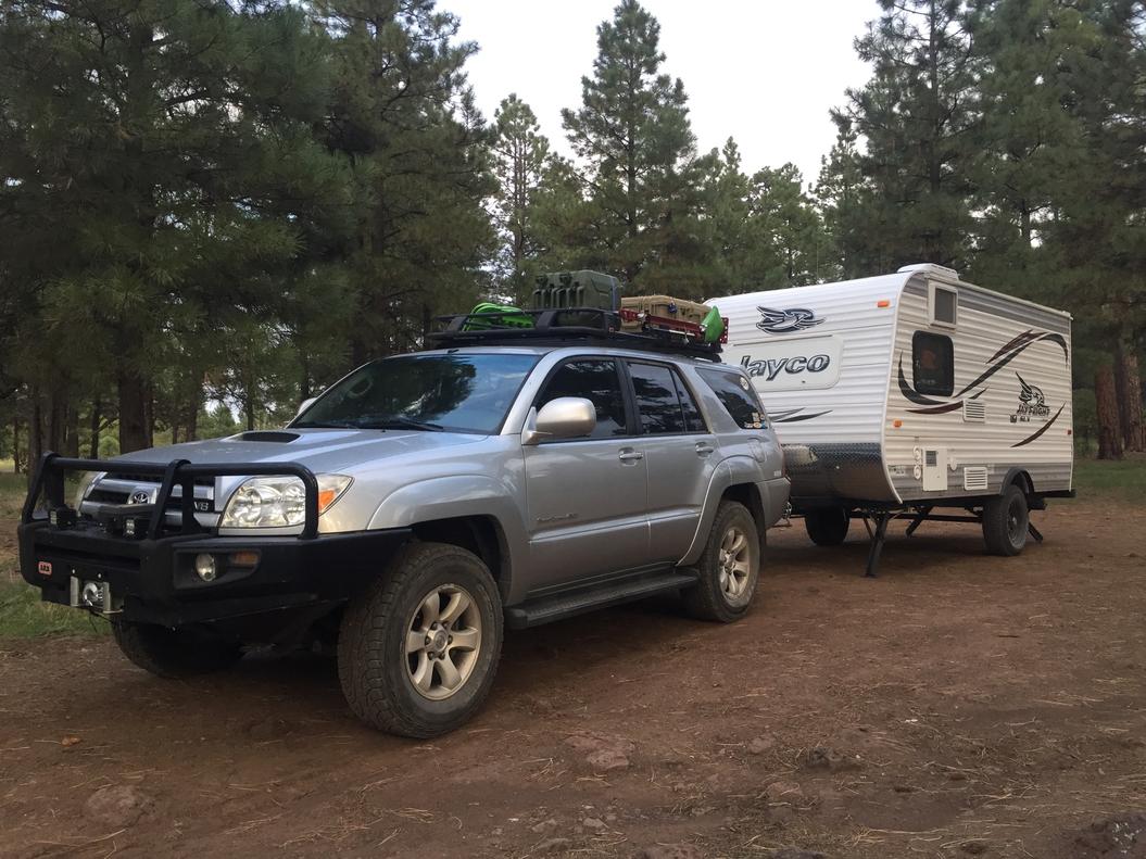

Well we just got back from a week long 1000 mile plus trip with the trailer and I pulled it with my 4Runner. It did great, I was very impressed with how well it pulled the trailer. I felt like it had more than enough power and just handled it well. The weight distribution hitch definitely helped and the brake controller was nice to have. The 4Runner always our trip vehicle and now after doing a trip with it its the trailer I'm going to just keep pulling it with the 4Runner when we take the trailer.
Thanks for all the help guys

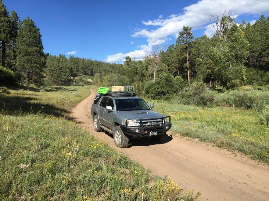

Plus it was nice to be able to leave the trailer at camp and go explore a little, I didn't really think about that before but it was a nice option to have.
