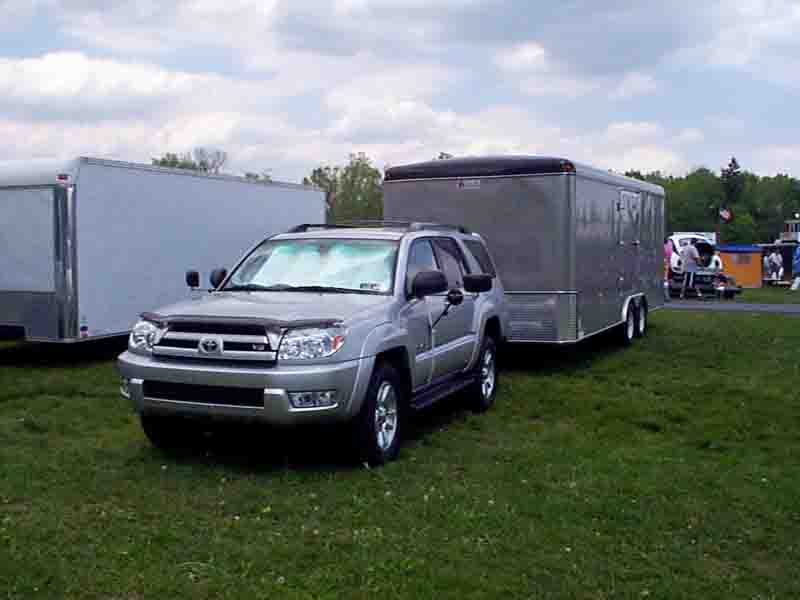

I use my V8 4Runner to tow my enclosed 20ft car trailer (~5,500lbs). The 4Runner pulls the trailer (even up some sizeable hills) without breaking a sweat.
A weight distributing hitch and sway control setup is a MUST when towing larger trailers with the 4Runner.
As you probably already know, sway control is very important when one tows in high wind areas or on roads/highways that have a lot of large truck traffic.
BTW, if the trailer you are getting is fairly wide you should consider mirrors over and above the standard 4Runner mirrors.
I use the McKesh mirrors. I tried the cheaper clip on mirrors but they simply did not do the job for me.
The McKesh mirrors provide a MUCH better view than the clip-ons.
The photo below shows my setup.
