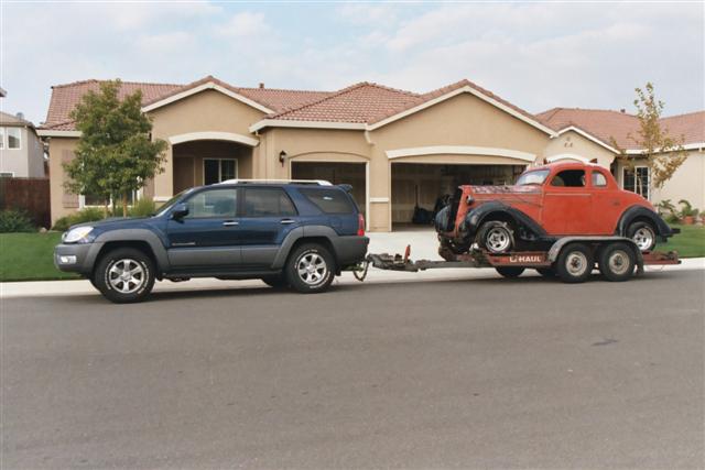

Anyone else do much towing with theirs yet.
I was amazed at just how well it did with this load which I carried about 180 miles home.
This next week (Thanksgiving), I will be towing it to Idaho from home, about 500 miles with a couple big passes to go over (one of them being Donner Summit) which will be the real test.

I will be soon. How much weight do you think you were pulling there out of curiosity? I got to get a trailer soon too. Did the U-Hual one work out good for car towing?

I am not 100% sure but not more than 3000. The car is solid steel of cousre and the darn thing is a bear to try and push/load.
The u-haul thing worked perfectly. I have used one from Penske also and it was newer and more heavy duty for a longer haul situation.

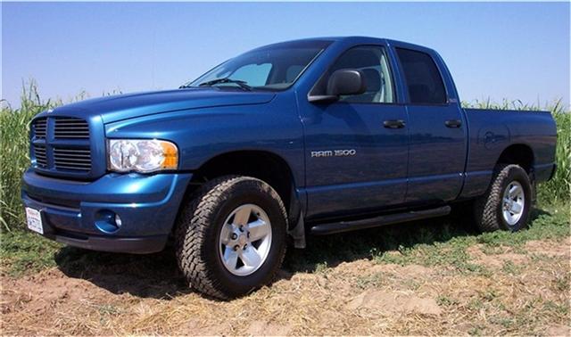

The truck thing is over rated I think... harder to park, less gas milage, and in this case less quality than Toyota. This is what I traded in for the 4Runner.
I beg to differ. I'll bet you a round of Beefeater Martinis that you're at or above 5,000#. That cast-iron U-Haul is at least 2,000# and I'd be very surprised if the car wasn't another 3,000# at least. The '03 Runners are only rated to tow 5,000#, of course.
I tow a Porsche 911 track car on a Trailex aluminum open trailer, and even that lightweight combo weighs in at 4,000#. I just got back from a trip from Michigan to VIR near Danville, VA, which involved lots of miles in the Blue Ridge mountains. My '03 did a wonderful job, including descending a long 9% grade with no brake problems, which used to completely fade the brakes on my '98 prior 'Runner. But, then, I used the gears to help brake the rig.
I would be VERY sure the trailer brakes on your rental are in working order, and be prepared to manually downshift to a gear lower than you think you'll need when descending steep grades to save the truck brakes. I'd also be sure that the shank of the ball is properly sized for the big hole in the ball mount (drawbar), and that the nut is torqued to the appropriate figure (250 lb-ft for the 1" ball shank, 450 lb-ft for the 1-1/4" shank).
I think you're going to be pushing the limits with that tow, and you'll want all the help you can get. Good luck.
-Karl
khaug,
You are right on the money with the trailer weight: 2100 lbs and on the car weight I may just be way off.
This is my first project car and I really do not know how much it weighs... but it is pretty much just a frame and a shell. No engine, no tranny, and the body/interior are bare.
Thank you for the insight with the towing suggestions! I greatly appreciate the tips and will heed them well.
The first trip/tow with it went so smooth and seemingly easy for the truck that I may have been lulled into pure ignorance.

What a coincidence. This is what my buddy just bought
I gotta admit, it's pretty cool. Hey, is it me or are the seat bottoms really short in the Ram?
Sounds like it's around 2000 - 2200 lbs. That should get you into reasonable territory for total trailer/load weight.
Toyota recommends you tow with 5th gear locked out. I do that unless the road is dead flat, in which case I tow in 5th. I get about 14.5 mpg towing at 70 on Interstates. Looks like your rig will probably have a bit more aero drag than mine (my car is lower) so you might get a tad less than that. I use 91 octane when I'm towing, but I don't know if that's really necessary.
I forgot to add that I'd check the trailer tire pressures before you start off. If the tires are trailer rated, 50 psi is appropriate. Otherwise, I'd use whatever maximum pressure is stated on the sidewall. I worked at a one-way trailer rental place when I was in school. Rental trailers don't get maintained!
Have a good trip and a happy Thanksgiving.
