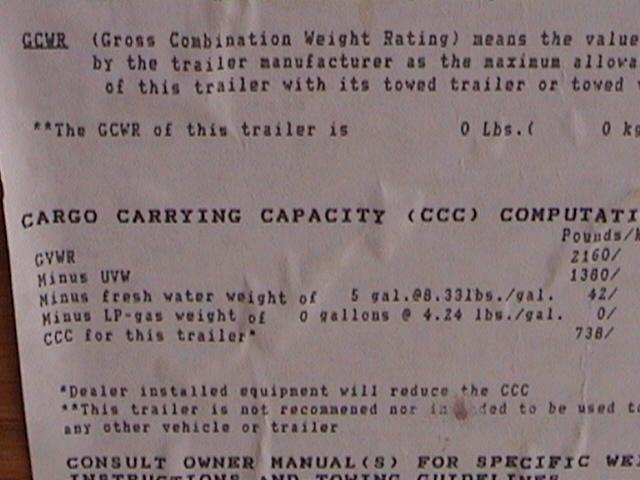

I moved this to the 3rd gen. forum. Your vehicle can tow 5,000 pounds. 4,100 pounds is what your trailer weighs before adding anything. That does not include your propane tank, water, personal items you put in the trailer. You need to look at the GVWR number not the UVW number. My guess is that your GVWR, the gross weight number will be way over 5,000 pounds. In my opinion the trailer is toooo big for your car.
When you look for trailers look at the GVWR number not the UVW number. Just my .02 worth. :)
Here is a picture of tag about what my trailer weighs, notice the GVWR weight. This type of tag should be posted on all trailers you look at. That should be one of the first things you look at. The salesman might say anything for a sale.
