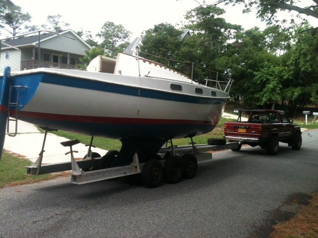

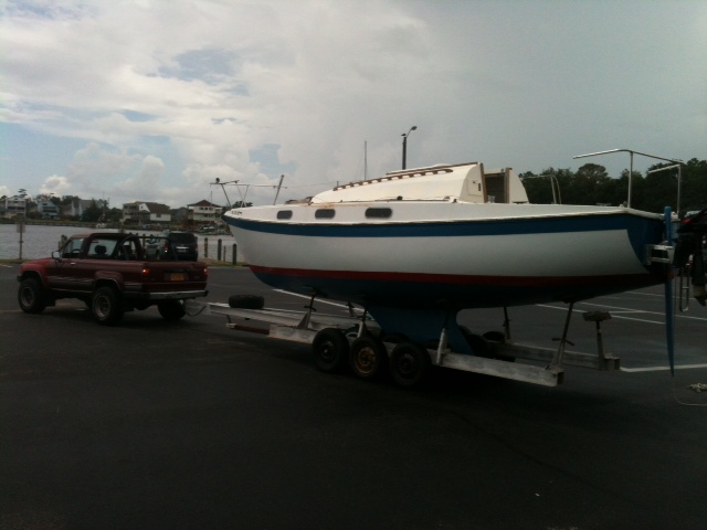

Towed this monster the other day......drove about 5 miles to the boat launch!

1st gear, 10 mph the whole way. I did have to drop her into 4L to crawl out of the steep boat launch......it was definitely interesting
Actually, doing low speed work like that isn't nearly as dicey as driving highway speeds and interacting with traffic. I've driven many a tow tractor with only a handful of HP that would do fine on a flightline. Here you're under fairly tightly controlled circumstances. There's a huge difference between what you CAN tow and what you SHOULD tow. I'd be willing to bet that 22RE in 4LO would tow a medium-sized commercial jet liner though there might be a lot of roasted clutch between here and there!
I imagine the light weight of your truck is the limiting factor getting that boat out of the water and back up the ramp. Only so much traction available though usually ramps are intentionally rough to help with that.
