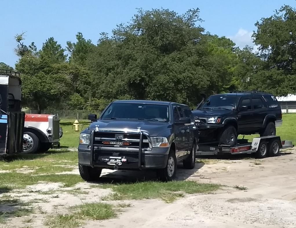

success; 2 front straps and front/rear safety chains.
