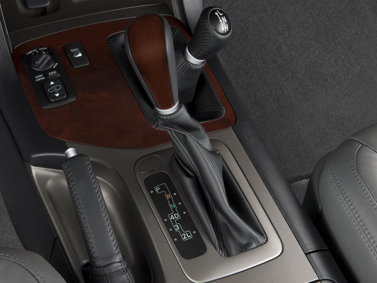

i agree with mikeync. there's only one instance of "multi-mode" buried in the toyota.ca site. all the other verbiage refers to it as a part-time 4wd system. seems only logical that the canadian SR5 and Trail have the same VF2A transfer-case as their counterparts in the U.S. meaning no 4WD on-road with the exception of the Limited.
fwiw, i think a torsen-equipped 5G (featuring multi-mode 4WD) that retained the 5G's new manual lever design (instead of the dial) would be an ideal setup— just like on the '09 Lexus GX470.
