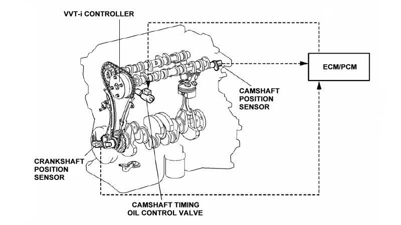

The cam timing valve assembly is not a sensor. It is a solenoid attached to a spool valve. It moves back and forth between 2 positions (in the 1GR anyway -- 2GR FKS has a linear position solenoid that allows the 3 different positions for the valve timing). In one position, the spool valve allows oil to flow into one passage where it goes into one side of a rotor assembly that changes the angular position of the camshaft relative to the timing. The other spool valve position moves oil into the other passage that pushes oil onto the other side of the rotor and that turns the cam back to the original position. There is an actual cam sensor that verifies that the camshaft is reacting correctly to the signal sent to the 'cam timing valve assembly'. Both of those parts are on the head cover (rocker cover as you call it). The cam timing gear (the rotor assembly that I mentioned above) is what I thought you meant they were swapping out. That does require the timing chain cover.
Cam timing gear:
Cam timing valve assembly (aka oil control valve):
Cam angle sensor:
The overall system:
If they really just changed out the OCV or CAS, that should have nothing to do with the short block side of it and the short block failure. That said, this engine shouldn't be any $9k or anything like that. car-part.com shows tons of them for under $4k.
