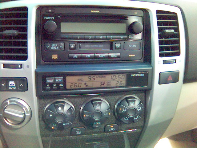

This is the factory radio on my european version 4Runner.
Does it have an aux input?
I would like to connect my iPod.
P.D. On the lower screen it shows the fuel consumption in liters per 100km. So far, it's giving me 30mpg highway/21mpg city (Diesel).

It appears identical to my stock 6 speaker system head unit. It does have an aux input but you'll need an adapter from PIE or Blitzsafe.
It looks the same as the US version. Do a search for P.I.E. adapter or Blitzsafe and you will find lots of info about an aux input for it.

Offroader said:
Maybe I'm wrong, but I don't see any button on my HU for a CD Changer.
Help please?
You press the DISC button twice to switch to a changer. You have to have something plugged in the AUX port in hte back for the feature to funtion.
Can I reach the aux input from the back, or do I have to disassemble the whole front?
Thanks for your help.

HU looks identical to my 2004 SR5 Canadian model.
My display is calibrated in litres per 100 kilometres, as is your's. I don't believe the computer, though, as on a recent highway trip, I consumed 11 l/100 km, which translates into 25.7 miles per imperial gallon. With the 4.7l V8, I doubt this is accurate.
