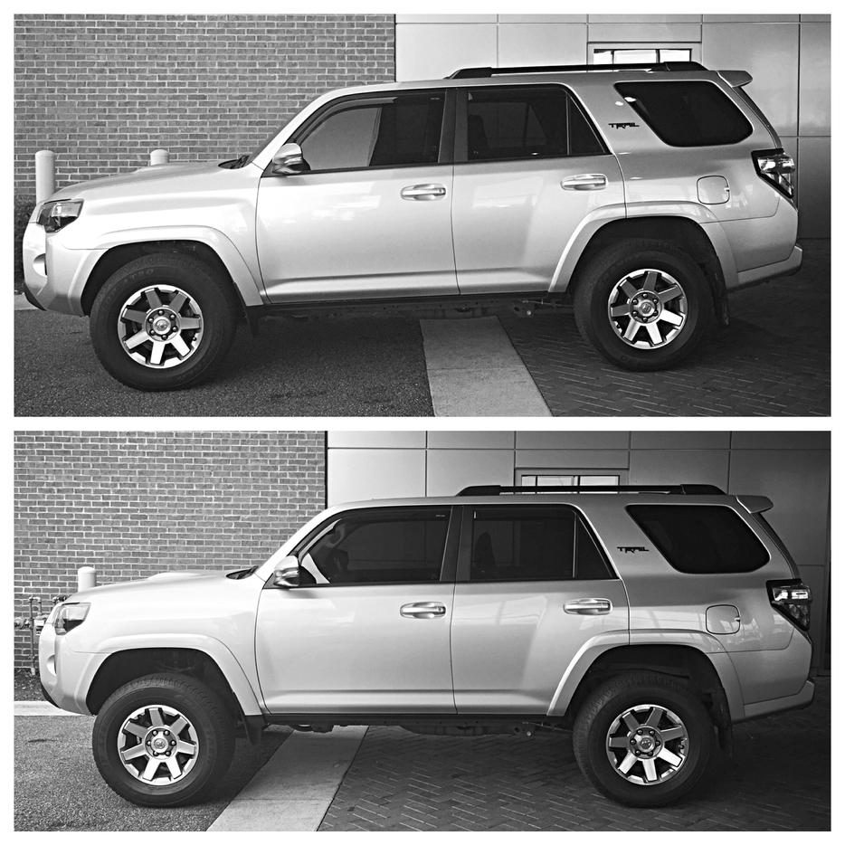

Haven't really seen many people using this kit. I wanted to fit a 33" tire but can't afford the complete Billstein lift kit at this very moment, but that I will eventually buy. So I decided to go with the 3" leveling kit from Toytec. I was hesitant because leveling kits usually make the ride a bit less smooth and harsh in my opinion, but this actually made my truck ride BETTER! It could just feel better because I'm sitting higher and the center of gravity counterbalanced with the 1'25" spider-trax spacers, but I'm blown away. I can't wait to put new rubbers on (285/70/17) KO2's in a couple of weeks. If any of you are looking to go with this kit whether temporary or permanently, I HIGHLY recommend it! Cheers!
I added a filter to this picture based on different times of days, weather, and photo clarity. Other than that, no changes. You can see the amount of stock rake, truck is on a slight incline in both pictures. :clap2:

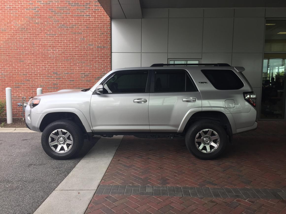

how's your alignmnet? UCAs?
No UCA's currently. Alignment is spot on! I got this done at the same dealership where I purchased the vehicle only because my friend is the service manager. I only paid $375 including alignment to get the job done. Mind you... this kit requires the FULL disassembly of your rear strut (unlike most spacer lifts) even with that he still hooked it up anyway with that price. The ride is beyond great I can let go of the wheel at over 60 mph and it'll stay nice and straight. Thought I would get some more roll and get pushed around in high winds as well, and I haven't experienced either of those. All in all, I'm whiling to bet I will keep this lift longer than I had planned on. Which will Free other money up to do other upgrades. Hope this answered your question!
