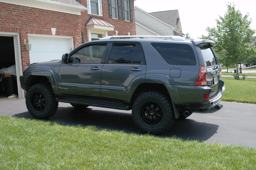

How does it ride compared to stock? Do you feel every bump now or is it about the same? I am going to purchase the same lift in a month or two and I want to know what to expect.
Did mine last week too. I do feel a bit more bounce in the ride........but it still rides great. And it's so damn nice being up higher!

Nice looking 4Runner! I really like the black rims. I just bought a set of Tundra rims that I am going to have powder coated flat black. It should look pretty nice with the Toytec Ultimate Lift.
Are you running Spidertrax wheel spacers?
No wheel spacers. The wheels must have the perfect offset. Front mudflaps needed to come off, but no rubbing whatsover with these tires, even at full turn.
Is that the radflo ultimate kit they have? or did you opt for the silver springs? Also when did you place your order as the bilsteins 5100 rear shocks are on backorder. Just curious as i'm wondering what the wait might be if I go with the bilsteins.. They have icon 7510's that they would substitute, wondering the quality on them.
I opted to go with the silver springs, just liked the coloring better. I didn't need to place an order since i only live about ten minutes away, just went in and grabed them. I must have got there at the right time since they had everything there and this was like the last week of April or so. I have heard good things about icon but have never owned them.
