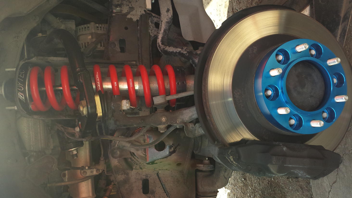

toytec boss coilover leaking
This is passage side it's fine

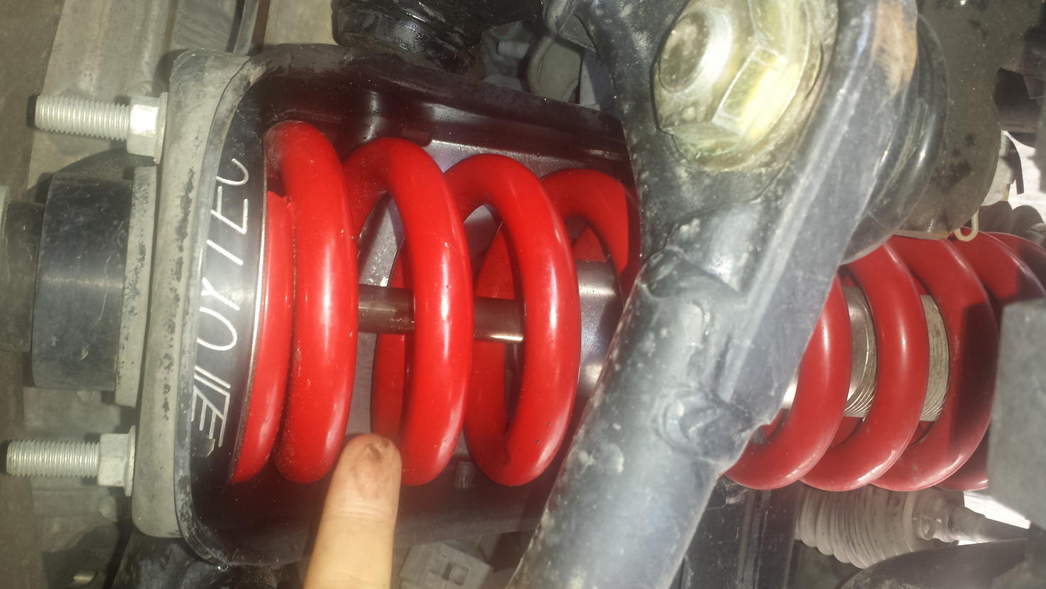

my tire also rubs only on driver side (the one that leaks) could this also cause my steering to vibrate

Take a paper towel and clean the shaft along with the area where the shaft enters the shock body. Check it again in a couple days. If it is wet then It's probably just a failing seal. Many shocks weep a little oil, but sometimes it can be hard to determine what is excessive. Is there any oil on the top inch of the shock body? Someone on TW had a Boss fail within days of install so this isn't the first.
Is there a nitrogen port or valve on those, if so do you have a way to check the psi? Or are they disposable shocks akin to the Bilstein 5100's they spec in everything else.
You could potentially feel vibration if the shock is completely done but it's unlikely.
But ya your shock is done.
