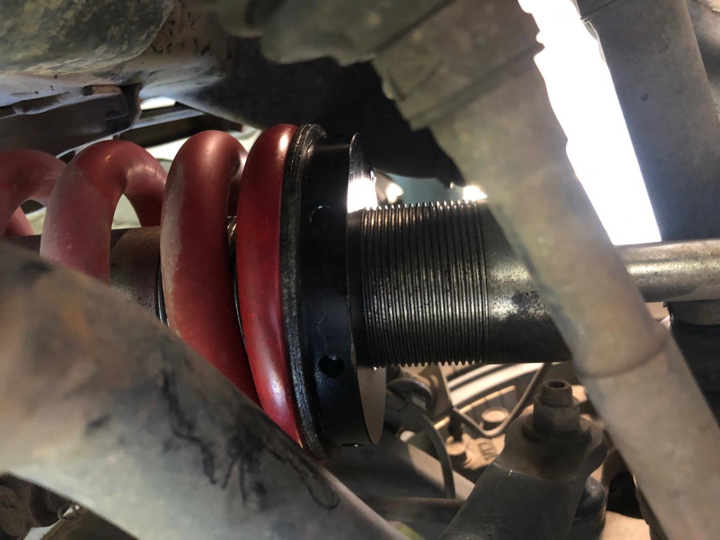

I'm having trouble adjusting my toytec coil overs as well. The instructions that it came with say to loosen the locking collar and then turn the adjustment collar. But mine only have one collar and I don't see a set screw holding it in place either. Tried turning it with cheater bar but it didn't feel right and was twisting the shock, got scared of breaking the weld at the bottom.
There is no locking collar on that version so your just moving the adjusting collar. It can be quite difficult to get moving, after that it's better. I do remember thinking the same thing when I adjusted mine. Spray it heavily with penetrating lube and let it sit for a day or so.
Remember to have the weight off the vehicle and it's much easier with the wheel off.
