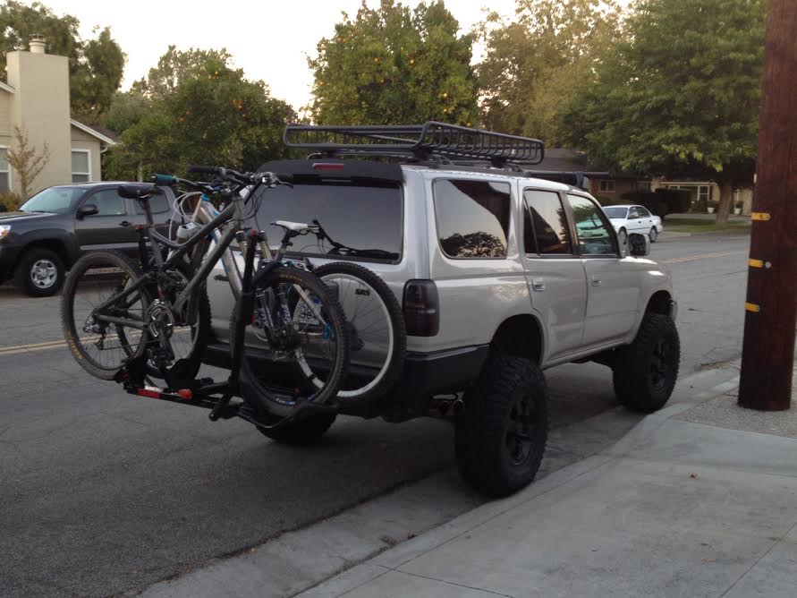

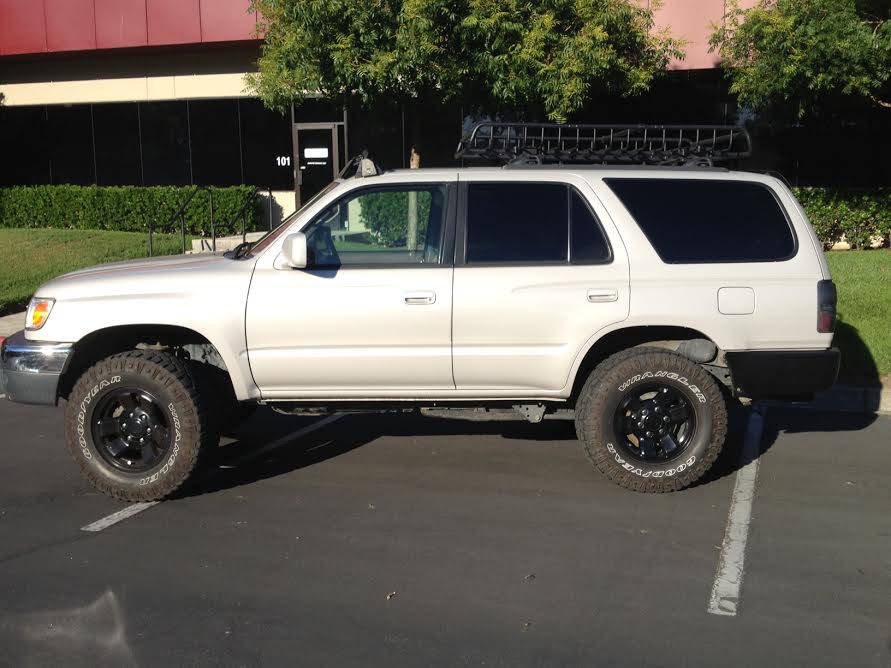

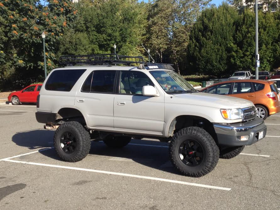

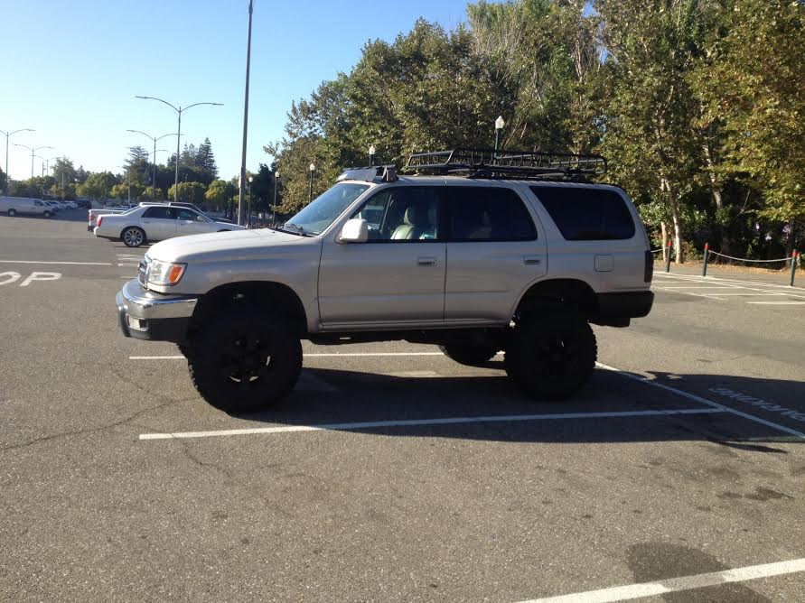

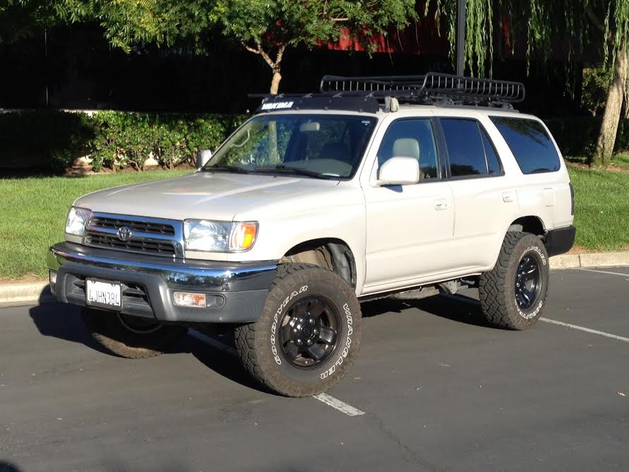

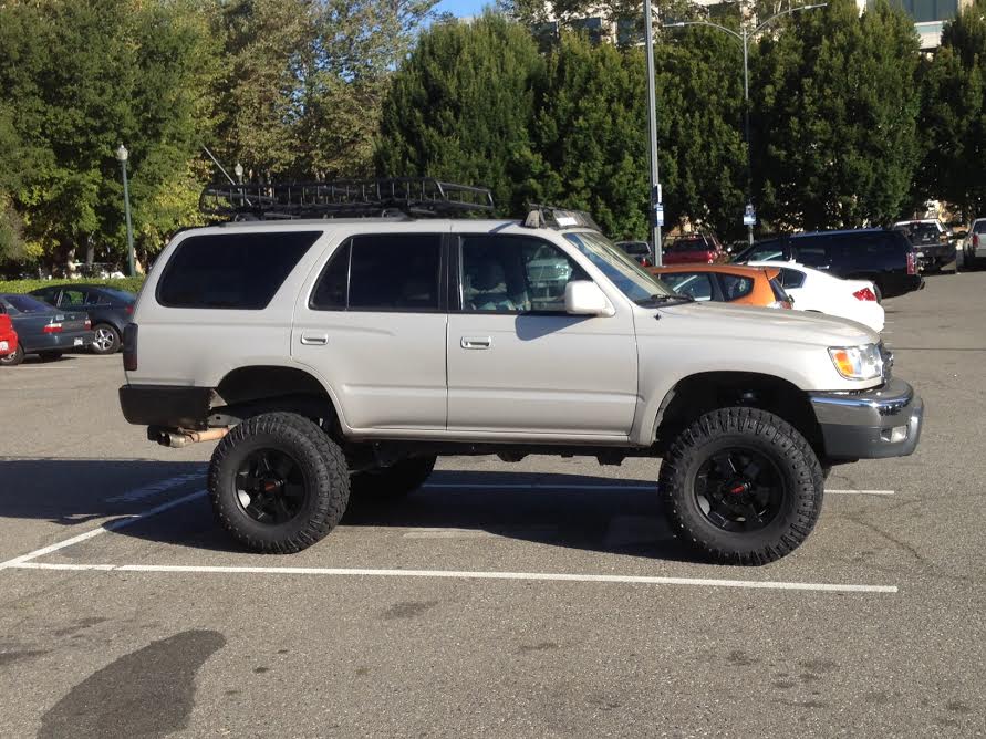

OK so here are a few before and after pictures.
The first two pictures are before photos, and the rest are the after photos. You can clearly see that the is a visible rake in the after pictures, but mind you, I did not adjust the coilovers at all from factory settings (which I believe is preset to give 2" of lift and they can go to 3.5"). I will be increasing the lift when the bumper goes on. The last picture is to show how the superflex coils handle a significant amount of weight for the rear. I had the two bike and the yakima rack which together is probably close to 125 lbs, plus a bunch of bags and equipment in the back.
The Toytec coilovers 'usually' come set at 3" of front lift just so you know.
