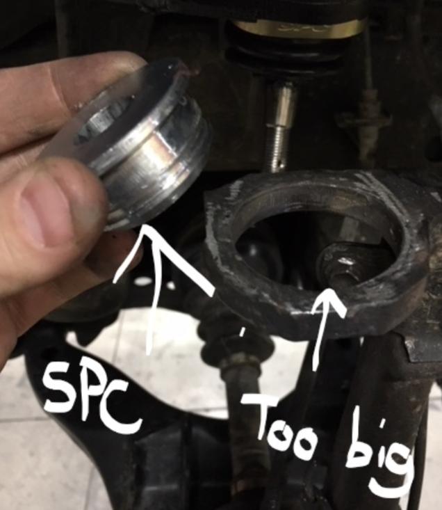

I saw a youtube video by a guy who ran into that issue with his Tundra, although I think he had aftermarket spindles. His fix was to peen/stake the OD of the adapter with a chisel, then press it in haha.
Check the OD of your adapter and ID of your spindle bore and call SPC with those measurements.
