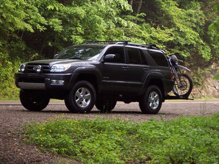

I run an OME spring in the back and cut down the spacer 1 inch to get the custom lift height. So that would make it about 5 inches over stock unloaded. No matter how much I load it up it will never sag lower than the front.
