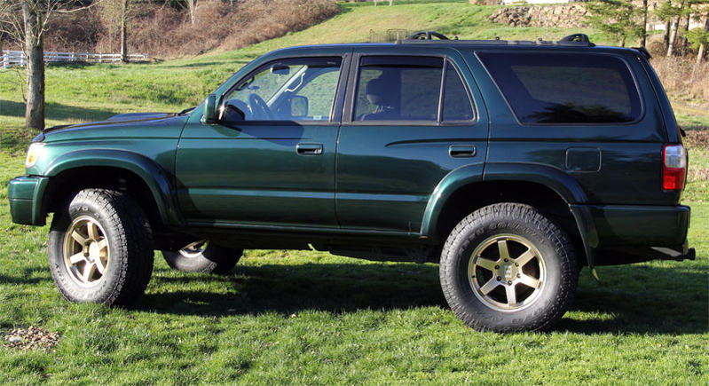

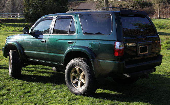

i bought the kit and was wondering, is anyone running 33s without rubbing issues and what the vehicle actually looks like with the tires on after the lift.
No rubbing yet but have only been out on very mild logging /fishing roads. I just now finished the Tundra brake upgrade and replaced the LBJ's. Won't be able to test it out until the middle of May.
32.8" (285/70R/17)
Toytec Ultimate
800# Silver
1" Diff drop
SPC UCA
OME 890 Medium load 3" lift
OME 60028 Sport Shocks
Level 8, -10 offset (No wheel spacers. Don't want to change the geometry too much)
One inch lift just to prevent any potential rubbing
