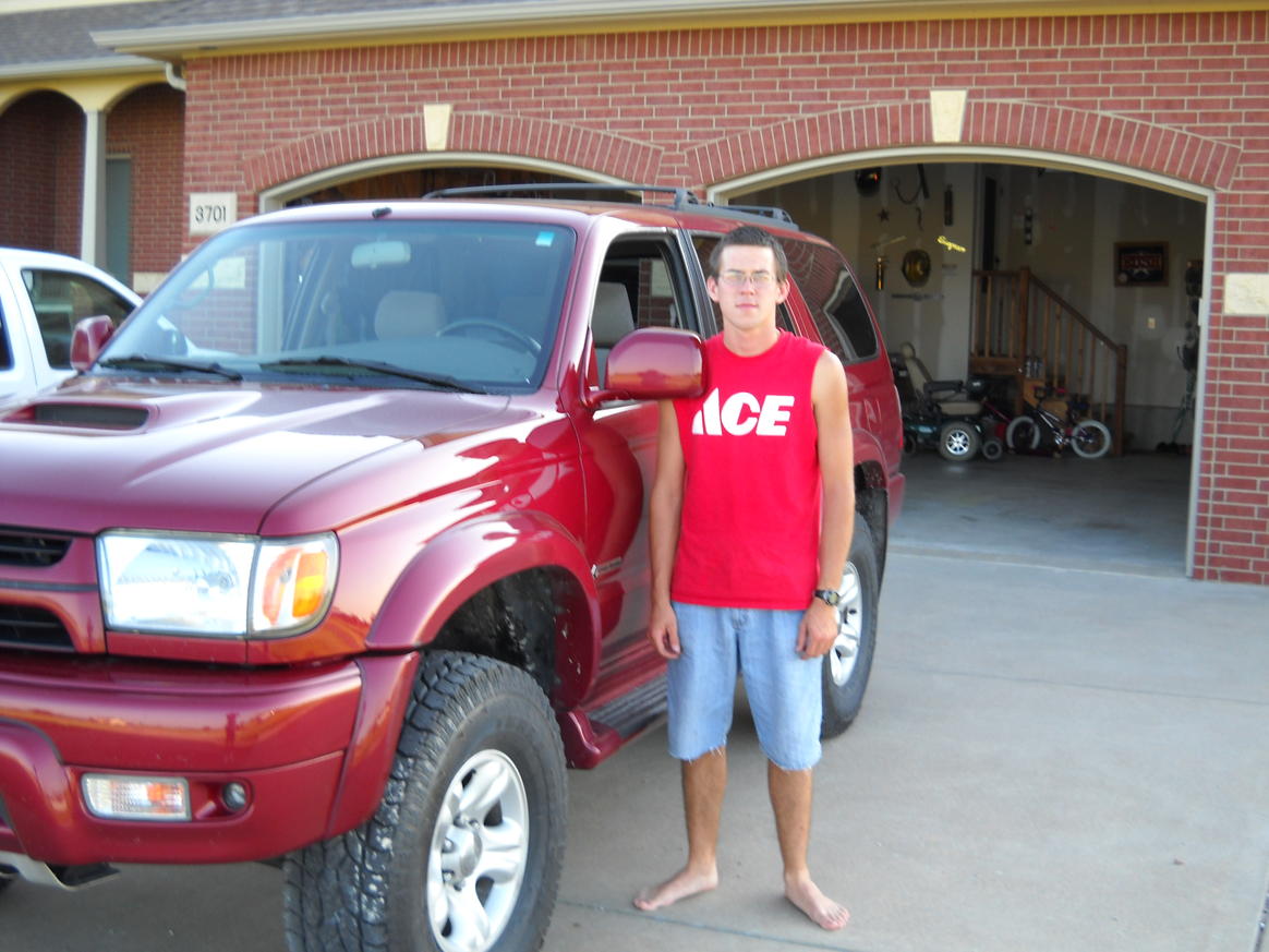

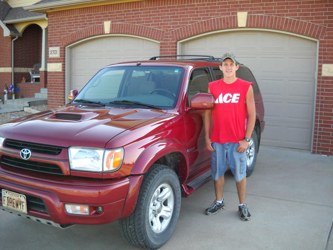

I went with the toytec 3" lift with diff drop and 285/75/16 tires. Here's before and afterrandom 2 095.jpg
Im very happy with the lift and ride
