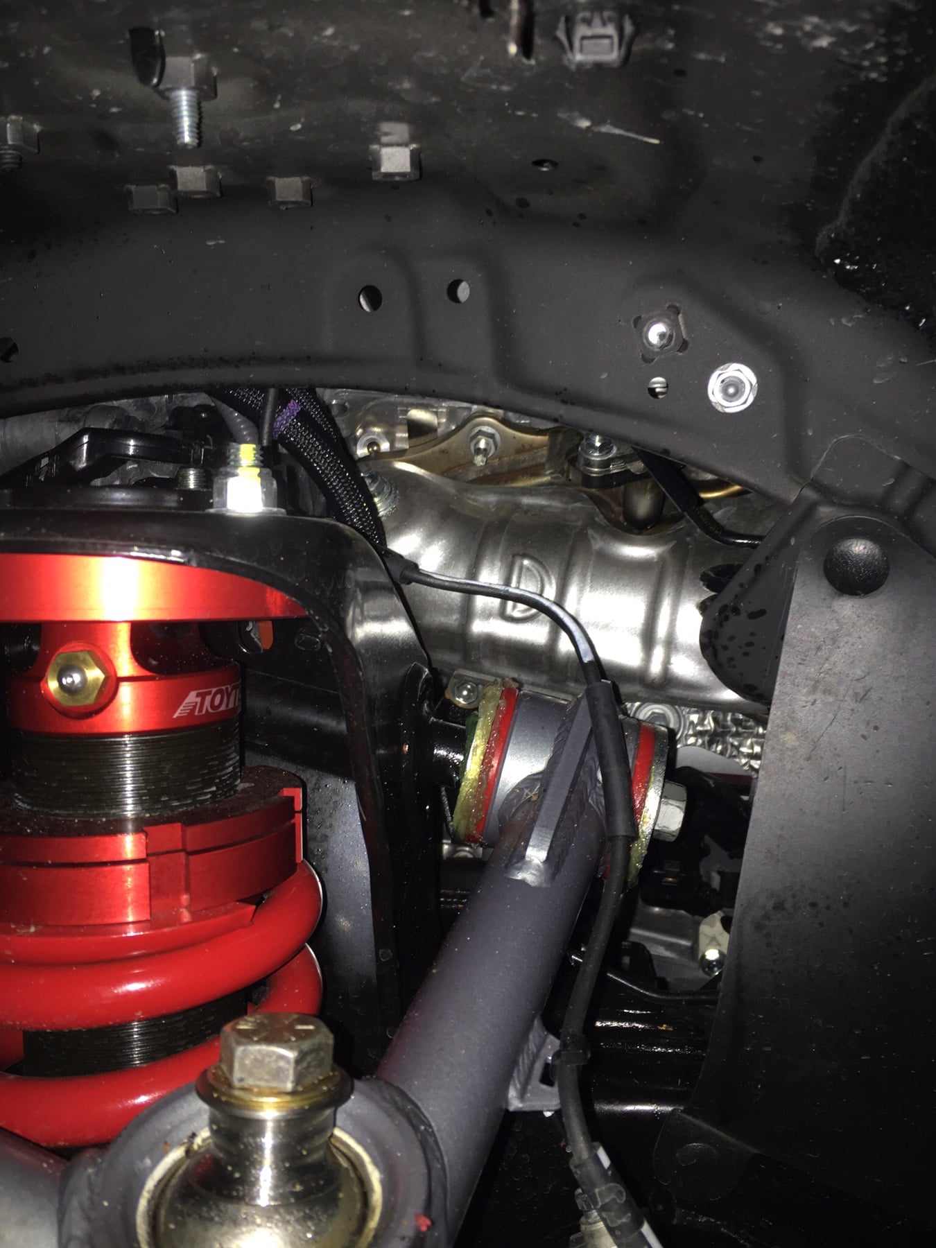

Is anyone else having issues with the Boss lift with Total Chaos UCA’s. Mine was installed 600 miles ago and the truck squeaks like a 1971 Ford farm truck.
This is not what I wanted on a $40k runner.
Get used to it unfortunately. I even took mine completely apart greased everything. It's the washers rubbing on the urethane bushings. Mine was only squeak free for a week.
Give us a picture of what the bushings look like. Many people over grease the zirks which make the bushings bulge. You don’t want the bulge. You can use a paper clip or an awl to release grease from the zirk.
My TC UCAs are silent for going on 2-3 years.... Could be install error. Have to grease correctly(as mentioned above)... and I do Dry lube the uniballs every few months.

Same here on mine, grease and I use a dry Molly lube for the uni balls...never made a sound
Had TC UCAs and they squeaked like crazy. If you actually use the truck off road and get them dirty / dusty, it's godawful. Greasing them correctly and using Tri-lube on the uniballs helps but it doesn't stop it. The fact that you have to loosen the bolts to properly grease the zerks is pretty aggravating, too.

Very true. I even called total chaos. They are the ones that recommended greasing everything. Even the parts they saw not to grease. I know for a fact it's the washers on the bushings. I can only get it to stop for a hundred miles or so.
So I have been back to the installer 3 times. It is definitely the bushings on the UCA’s. They have been cleaned and regreased twice. No noticeable change. Ordered another set of bushings today so we will see if that helps. If not I will have a set of UCA’s for sale. I am OCD AF about squeaks and rattles
Let me know if those help. I was thinking a slight dimple in the washers would back them off the bushings just enough to not let them squeak.
