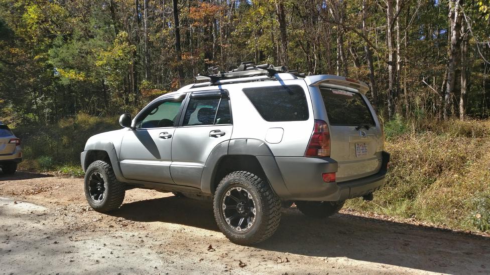

2) Lift question: My truck currently has a 3/2 Readylift spacer kit on stock springs, paired with entry-level Billstein shocks on each corner. They are the basic blue/yellow shocks, not high end 5100's but I'm not sure what they are exactly. No idea how long this setup has been on the truck since it was the owner 2 owners ago that installed the lift/tires/wheels. The previous owner also included a full set of FJ trail team coils, uninstalled. Can I replace my current factory springs with these FJ's without much fuss, using existing shocks? And can I keep the spacers with that setup or would I have to only use the springs as the lift because they are slightly taller than the OEM? I don't have money for a real Toytech lift kit (and no particular need for it other than aesthetics) so I'm trying to make it look the best (tallest) that I can with low funds. It already has trouble getting aligned correctly as is, since it has stock UCA's.

2. The blue and yellow bilsteins are actually almost identical to the silver 5100s. the rears have identical performance and valving and the fronts are only valved different because they need to handle the adjustment of the spring perch. To answer your question about the springs, not at all easy to do. It is doable, but not easy and really not worth it IMO. From my eye, your rig looks fantastic. sits perfect. dont fix what isn't broken. However, if you insist on replacing or want to try to get the alignment a little better, then you could ditch the front spacer and try a bilstein 5100/fj spring combo. there is a ton of archived info on here. you are just going to have to find it. I run fj springs all around with bilstein 5100s set to .85 in the front with no spacer in the rear. search "painkiller" for my build and you will see hwat that looks like on 265/70/16s. not as impressive as yours and that wont clear what you are running, i dont think.

Thanks! So sounds like I won't bother tackling the FJ spring installation then. I just figured it may be a good idea trying to use them since after 13 years and 150,000 miles the stock springs are likely pretty worn and tired, and I already have the springs sitting in my garage. But I'll probably just sell the set of FJ springs in the classifieds then.

Is there a post somewhere listing the hub to fender or ground to fender measurements for stock and lifted 4th gens? Specifically the 2003 V8? I would like to find some height measurements to compare mine to. I'm fairly certain the spacer lift on it is a 3"/2" kit, but I doubt it has a true 3" lift at this point due to spring fatigue. I couldn't find much from searching.
