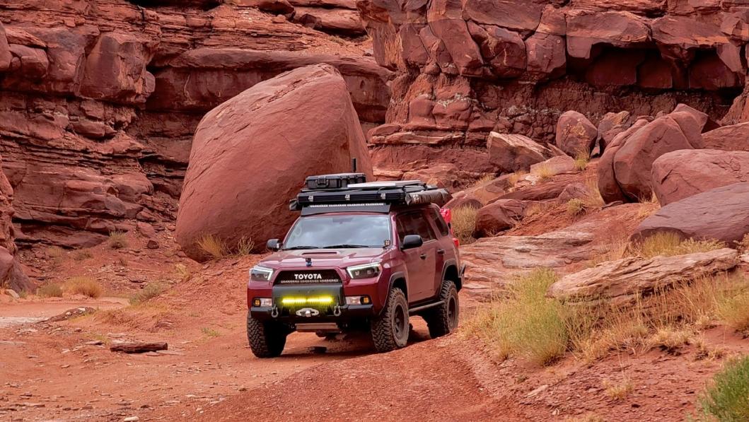

285/70/R17 Nitto Ridge Grapler tires fit without any mods. Slight rub when reversing at full steering lock is non-issue in my opinion because it is rare and inner fender liner contact. Some mods:

Thanks so much for this! That's great to know the 285 70 17s fit. I agree a little rub full lock in reverse is no big deal. Definitely the look I'm going for the wheel wells just look too void right now and need some width on the tires too really fill out the stance too. I love the trd bead locks I've heard they're pretty much impossible to get
what size lift are you running. Btw I love the sliders too. Exactly what I want, I have 2020 steps but I only got them for my mother when she was visiting as she has a bad him and needs a step to get in. Much prefer the slider style tube steps like you have. May end up making something myself.

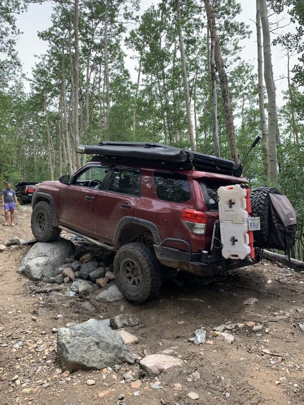

285/75/17 Yokohama Geolander MT but I’m due for new tires soon so I’ll probably jump up to 315/70/17. To get the 75 wall to fit I had to get a BMC, pushed fender liner, pinch welds, and lots of trimming and I still rub abit. Planning to get relocate cab mount and C4 fender liner for the 315s
