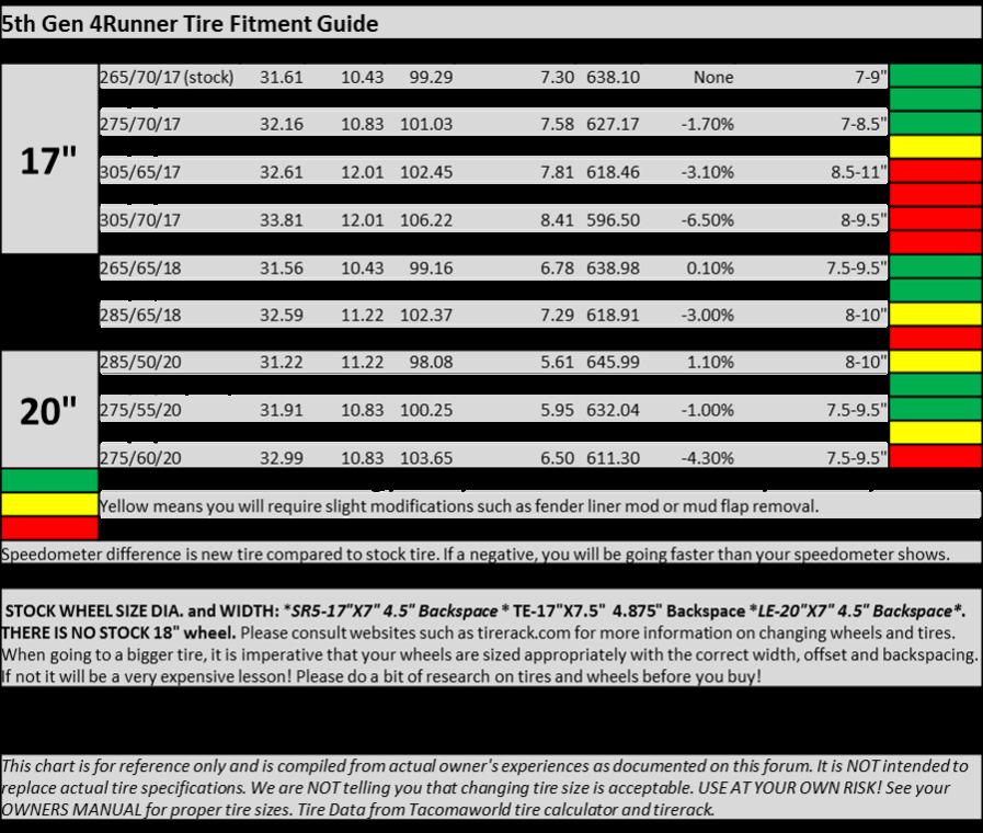

Not being sarcastic. We ASSUMED that you would know that all 4Runners have the same hubs, frame, similar suspension components, etc. Now, the link I provided you shows a chart and talks about the only difference between the different model's wheels. It's towards the bottom and talks about wheel width and backspace. Here:
