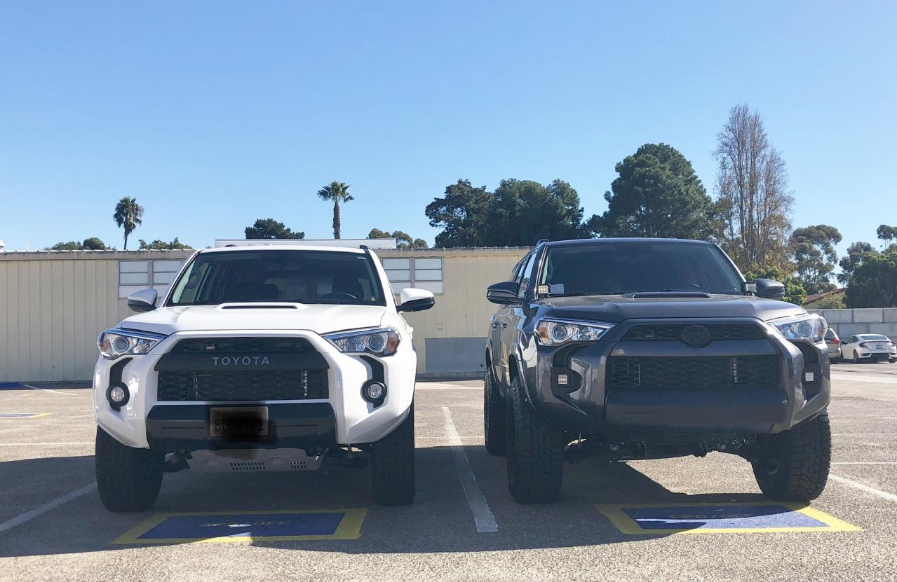

The Fox OEM on the Pro is not a big upgrade compared to my 5100/Wheelers suspension with JBA UCAs. I’ve driven both recently, and the roll and nose dive us still worse on the Pro than my Trail/KDSS. I’m also sitting almost two inches higher...
It's a huge upgrade. You're comparing $100 digressive shocks to $4,000 progressive bypass shocks. But for the height issue, I'd trade my fox factory shocks for trd pro without question.

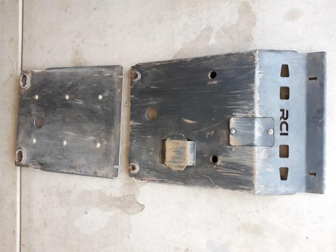

My RCI skids were at 8.75" at the front edge about the same a stock KDSS has to the factory skid. Clearance was at 8.1" under the differential bulge and 8.25" to the rear of the skid. I just put Dobinsons 59-238 chiefly to correct for the clearance lost to skids.
EDIT: not sure why the picture is not showing. Nothing special anyway. Just shows use. The front edge was completely stripped of powdercoat before I repainted all skids last week (and chased the tread of all holes and replaced some of the bolts).
Also, I can discuss minor clearance changes at nauseum but it is hardly on topic here.
