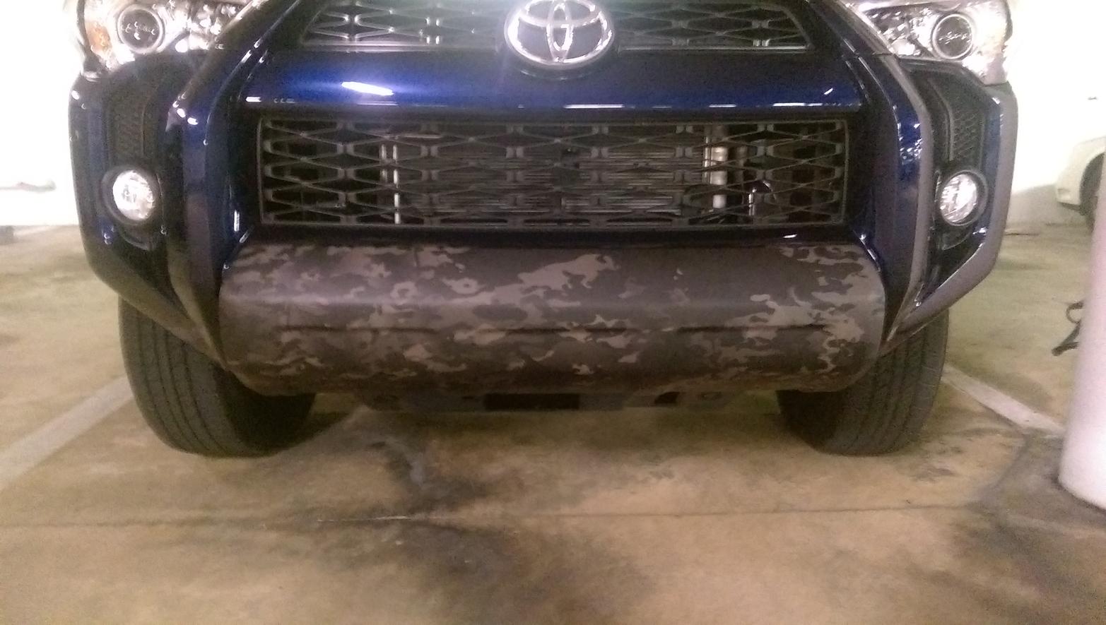

most people either plastidip or wrap them flat black. I wrapped mine in a black camo
I wish I could find a brand new one for fairly cheap. I HATE that the dealer poked holes in my bumper to stick that damn plate frame on...
its darker in person, that was a cellphone pic in a garage under weird lights. Ill eventually get around to taking better pictures of it and you can decide for yourself

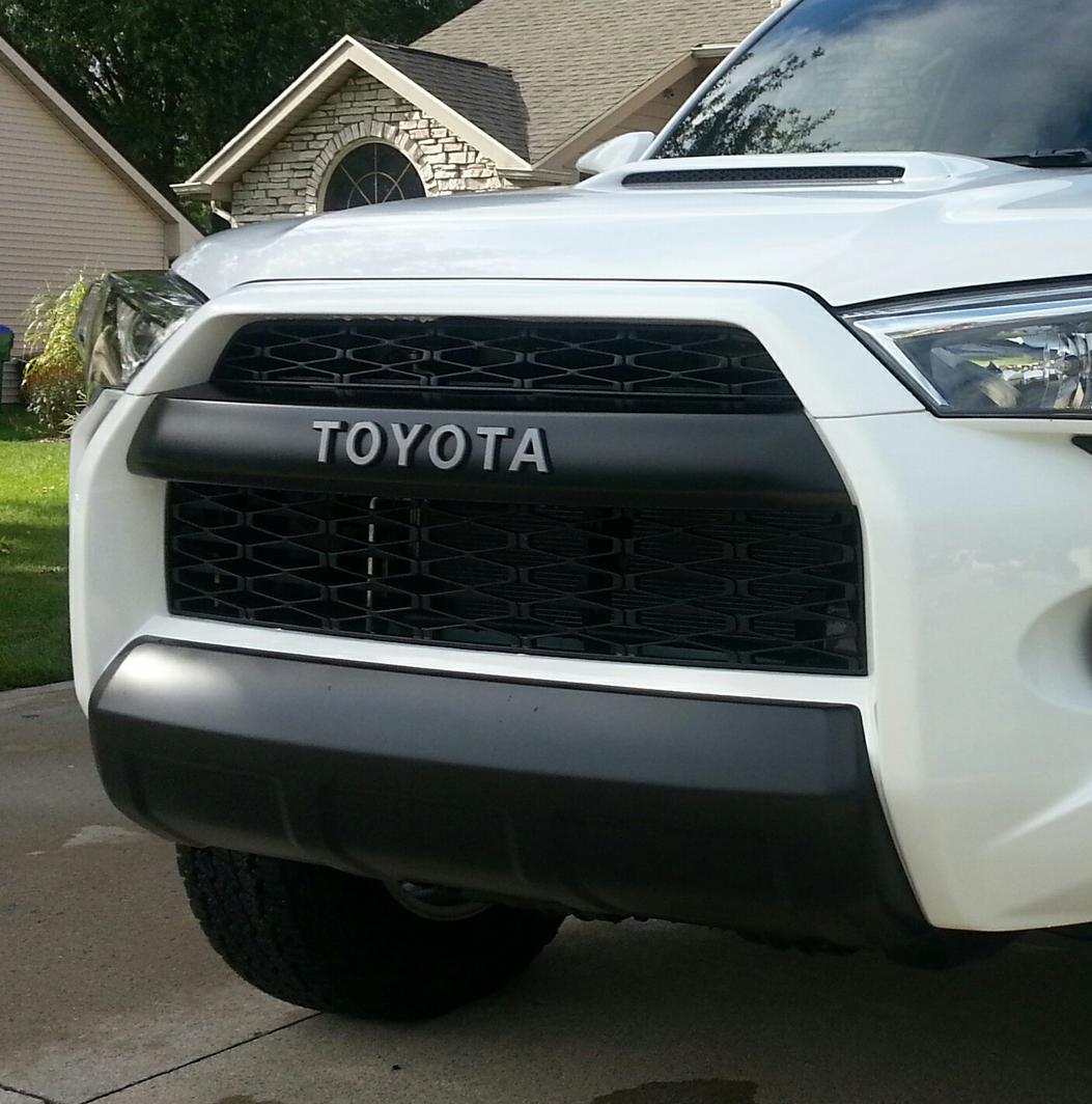

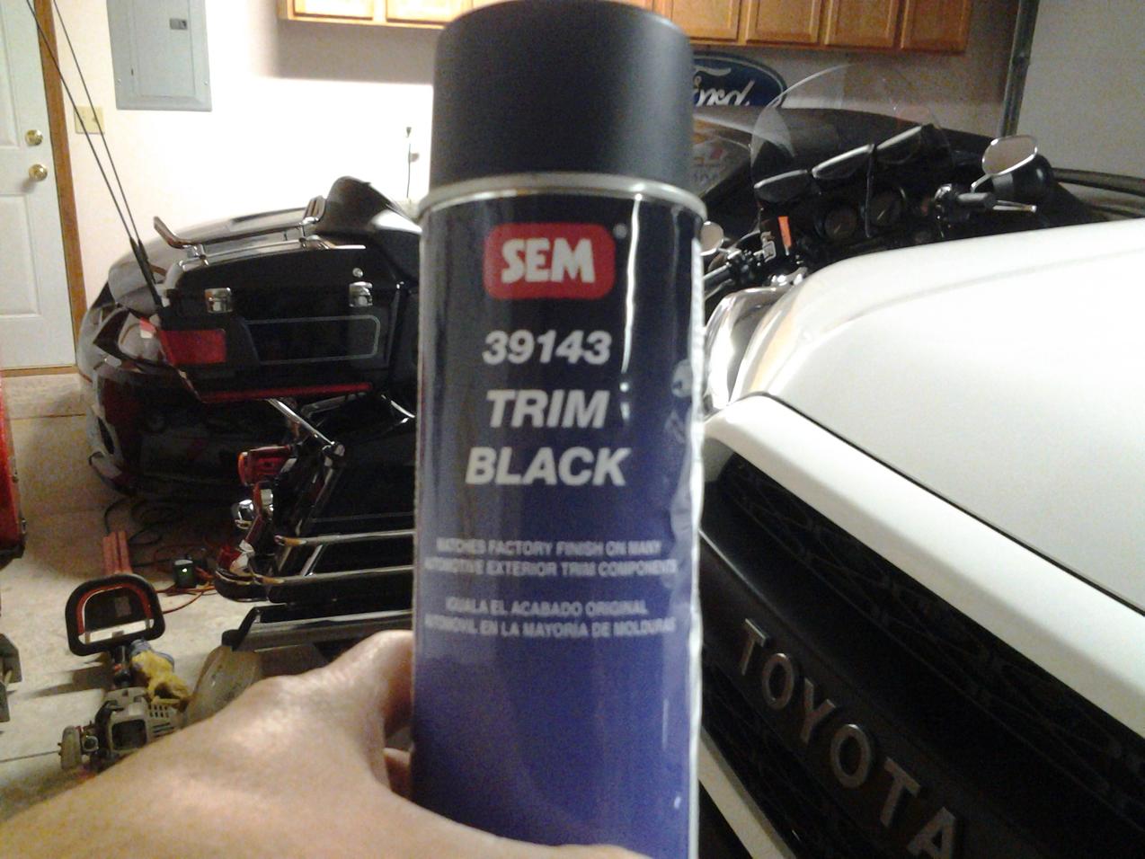

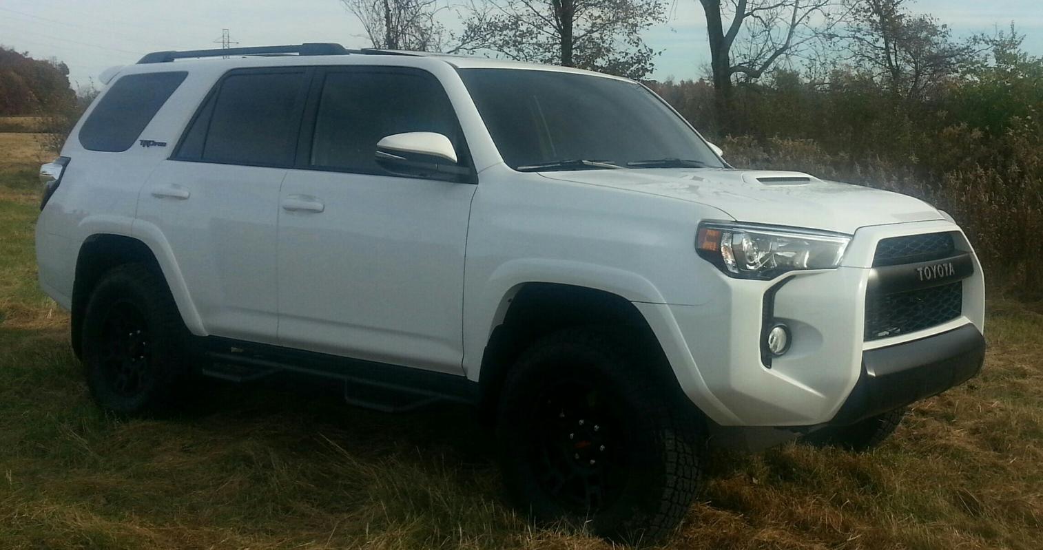

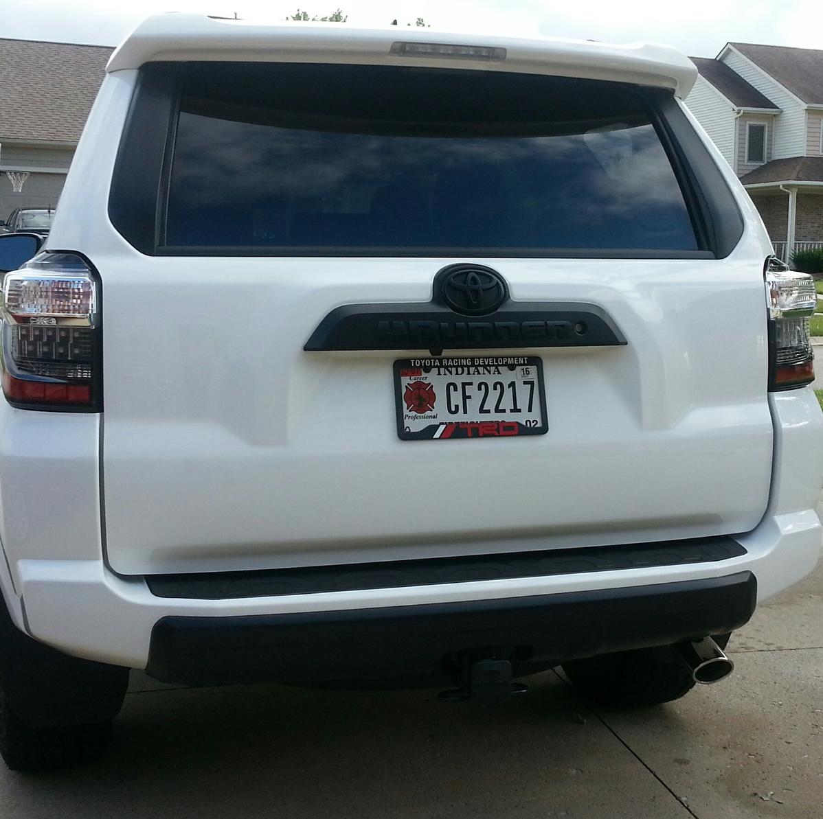

Here is what I used when I did mine. Have used this product for years. Remove pieces that you want to paint. Scuff shine off paint with a auto body scuff pad. Wipe down part with mineral sprits. Spray 3 light coats of trim paint. Allow 5 minutes in between coats. Dry to touch within 30 minutes. Fully cured within 24 hrs. Matches all other flat black paint on truck. Here is a picture of the product and a couple more of parts painted. Front and rear valance, roof rack rails and emblems. Picture of stripes I laid down on my mustang 8 years ago. Very durable product. Great for spot blending also if needed without repainting piece again. A lot better look then plastic dip in my opinion. Just another option for anyone that is interested.Runs about 16.00 a can and scuff pad is 3.50
