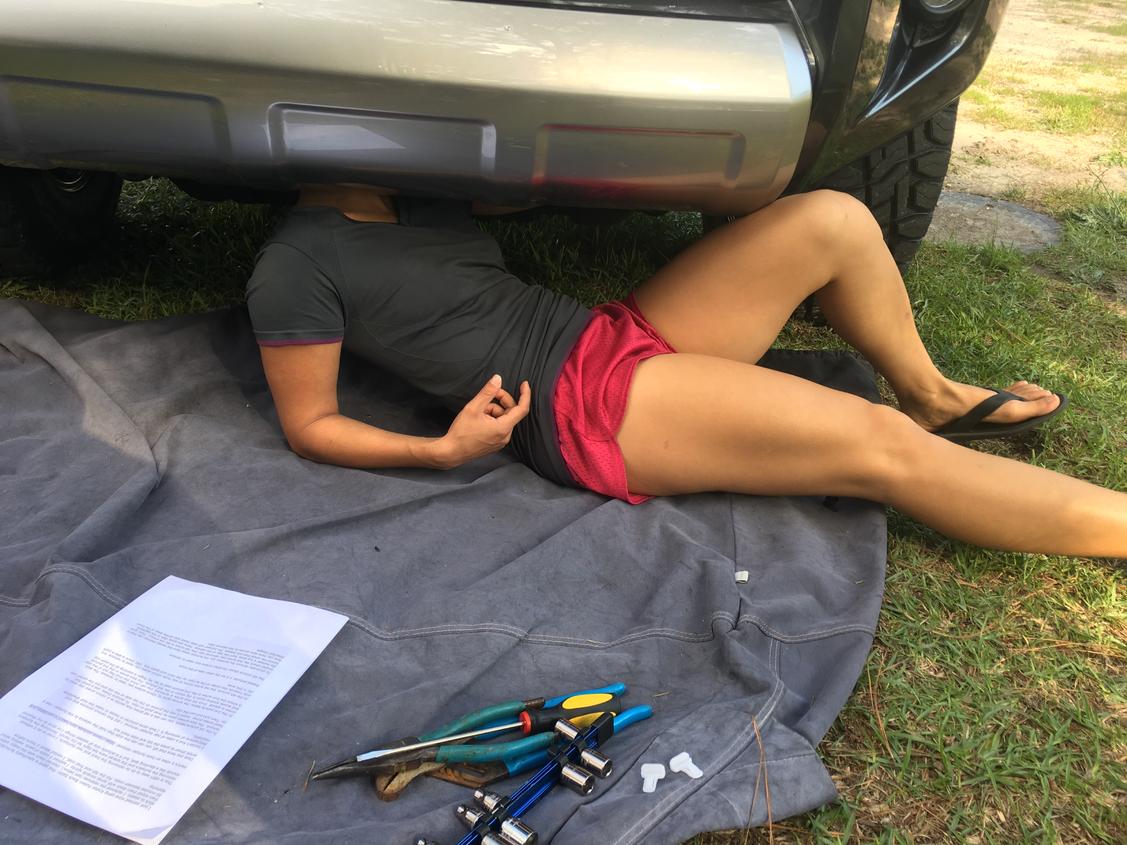

I would say unless you have the hands of a small child then you will need to take the bumpers off, I tried to do it with the bumpers on and failed miserably, just bit the bullet and took the bumpers off, its really easy and makes the job much easier....
My wife had no major problem getting the clips off I couldn't get to with the front bumper on. Recruit a gf/wife/hot random girl off the street.
My fiancé is pretty little and she likes working on cars, may need her small hands to assist.

I did it myself without removing the bumper. It was super easy. Didn't break a clip. Took all of 30 minutes. I could probable do it in 10 minutes the second time.
