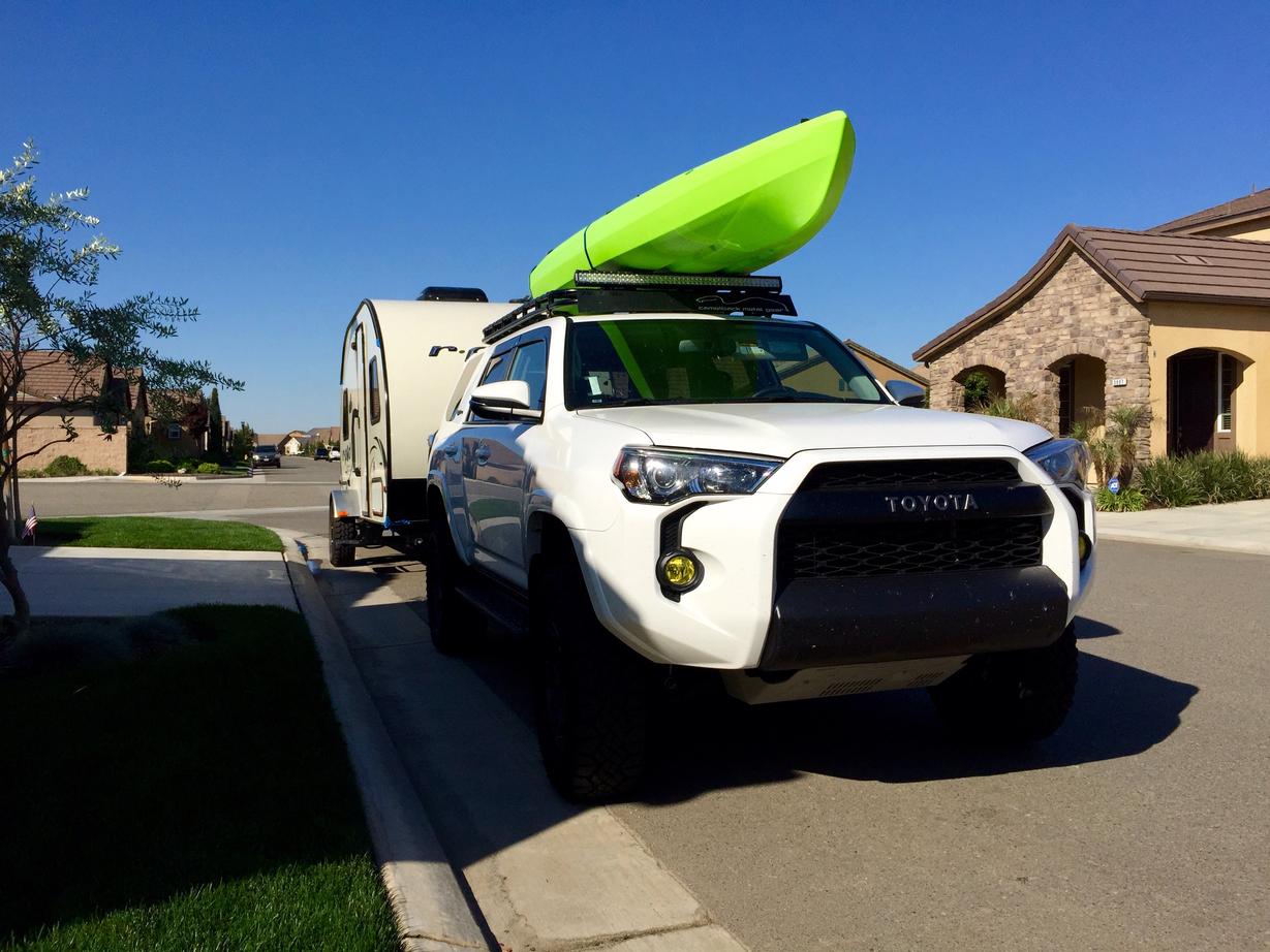

Thanks for the responses! Especially for the advice!
When I started up the 4Runner with the trailer hooked up thus morning, all lights were gone. Drive to DIY car wash, and back, no warning lights. Must be the override. I will change the ground connection when I return, but for now we should be good to go!

Unrelated but nice set-up! I definitely want to get one of those Hood River Edition Rpod's at some point.
