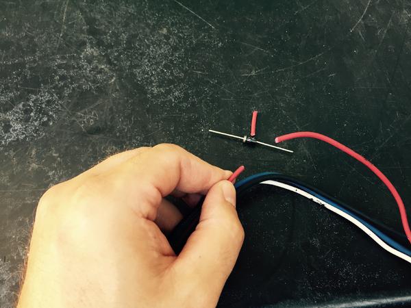

I just had an email conversation with their tech support - The short version is that I asked what was different in the new harness, the answer is a 1 amp diode (any voltage above 15v should work) installed in the red line...
I am not going to order a new harness, I'm just going to add a diode.
Here are some diodes that would work fine:
Amazon.com: Install Bay Diodes 3 Amp 20 Pack- D3: Car Electronics
While $5.43 is cheap in general it's expensive for diodes... but it certainly is easy to get them this way!

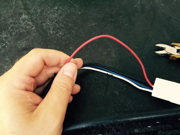

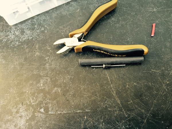

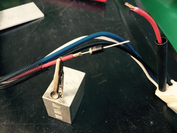

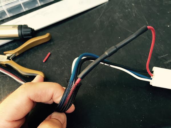

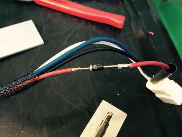

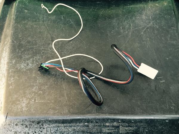

In what direction should the diode be installed on the red wire to correct the back feed?
Sent from my SM-G900V using Tapatalk
You can do it!
No more codes!
Yes, it works ! I bought this diode and I do it ! And the most important... everything is good !
** 1N5401 (3A, 100V) 1N5401 General Purpose Diode: 1N5401 - 1N5401 100V 3A General Purpose Diode
