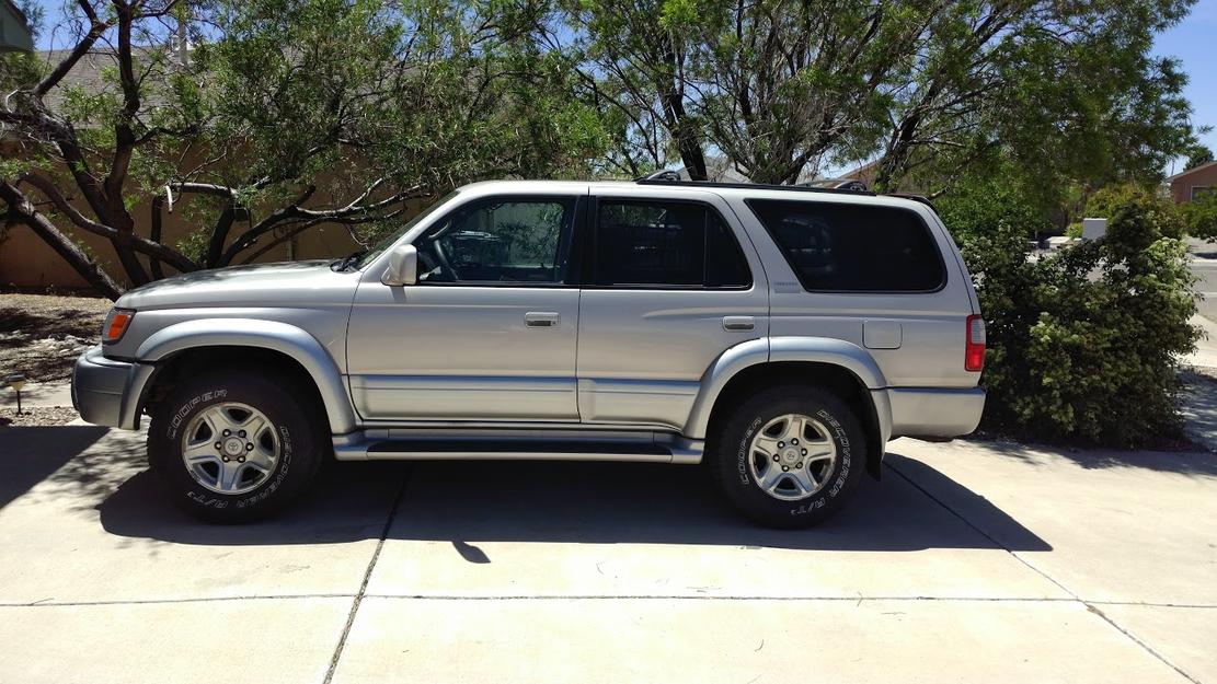

I have read about installing the Tundra front brakes with a fair amount of information about that and a lot of opinions where to buy parts, which changes based on pricing. Local junk yard wants $50/ea for calipers so I think I will go with reman. The first question is can my wheels handle the 213mms ones? I heard the 5 spoke was good with the 213mm and I have a 5 spoke, but what if my 5 spoke isn't the right 5spoke? Have attached a picture showing the vehicle so maybe someone will recognize the wheels as 213 compatible or not?

Thanks, I had read that article but didn't notice the "pic" link which does seem to be my wheel, just much prettier :)
I had bought rubber recently, still in great shape and my wheels work, so it looks like what source I use for calipers and rotors. Thanks.

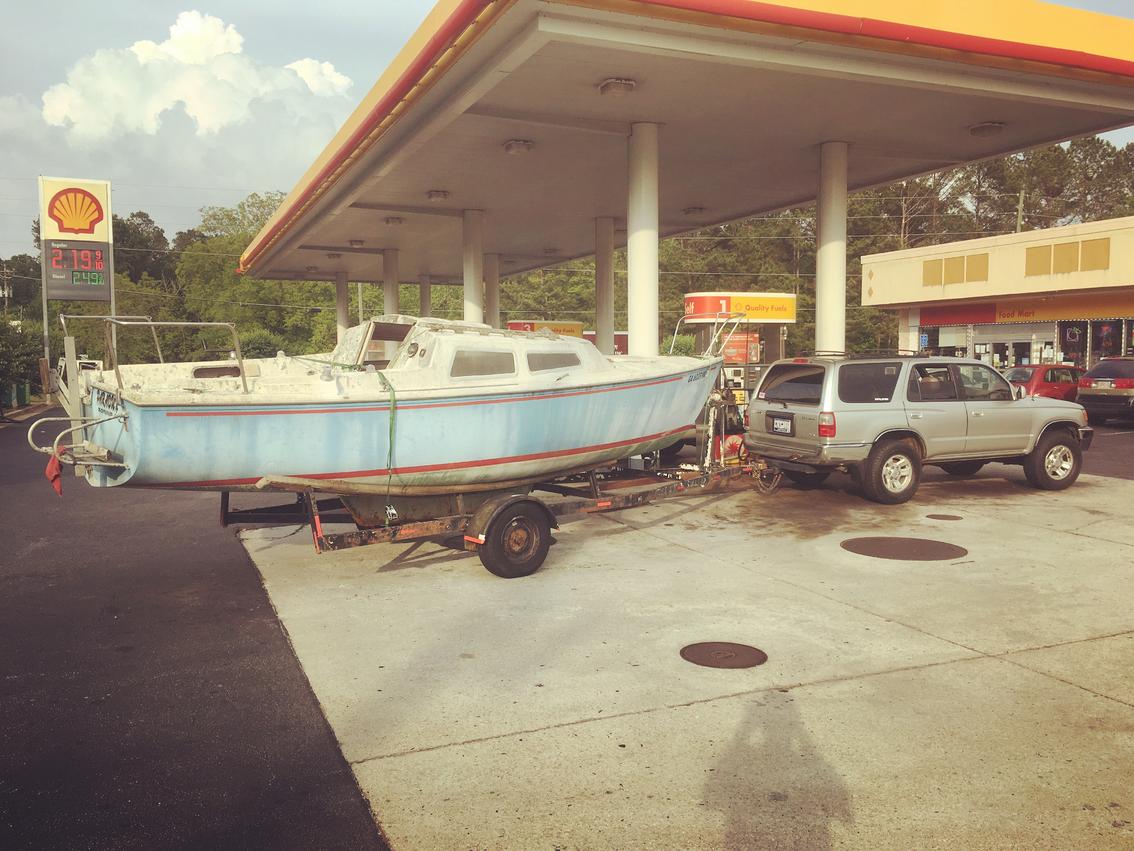

I managed to haul a 22 foot sailboat that weighed in right at 3300 lbs from Atlanta to Greenville, SC (about 200 miles) over backroads. As [MENTION=148161]Drummermonkey[/MENTION] said, realize that you can't haul as fast or as nimble as you drive and you should be fine even with everything stock (like me). I would kill to have electric brakes though...
