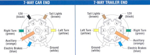

I have a trailer I used with my former GMC Jimmy--The Trailer Wiring worked fine using the 7-Way Adapter to 4-Way Connector. I am trying to use the same trailer and its wiring system with my 05 4R--I am having difficulties getting the trailer's light to work with my 4R. I am using the 7-Way Adapter to 4-Way Conncector supplied by my Toyoda Stealer. Can anyone out there shed some lights on this?

Hope this helps.
