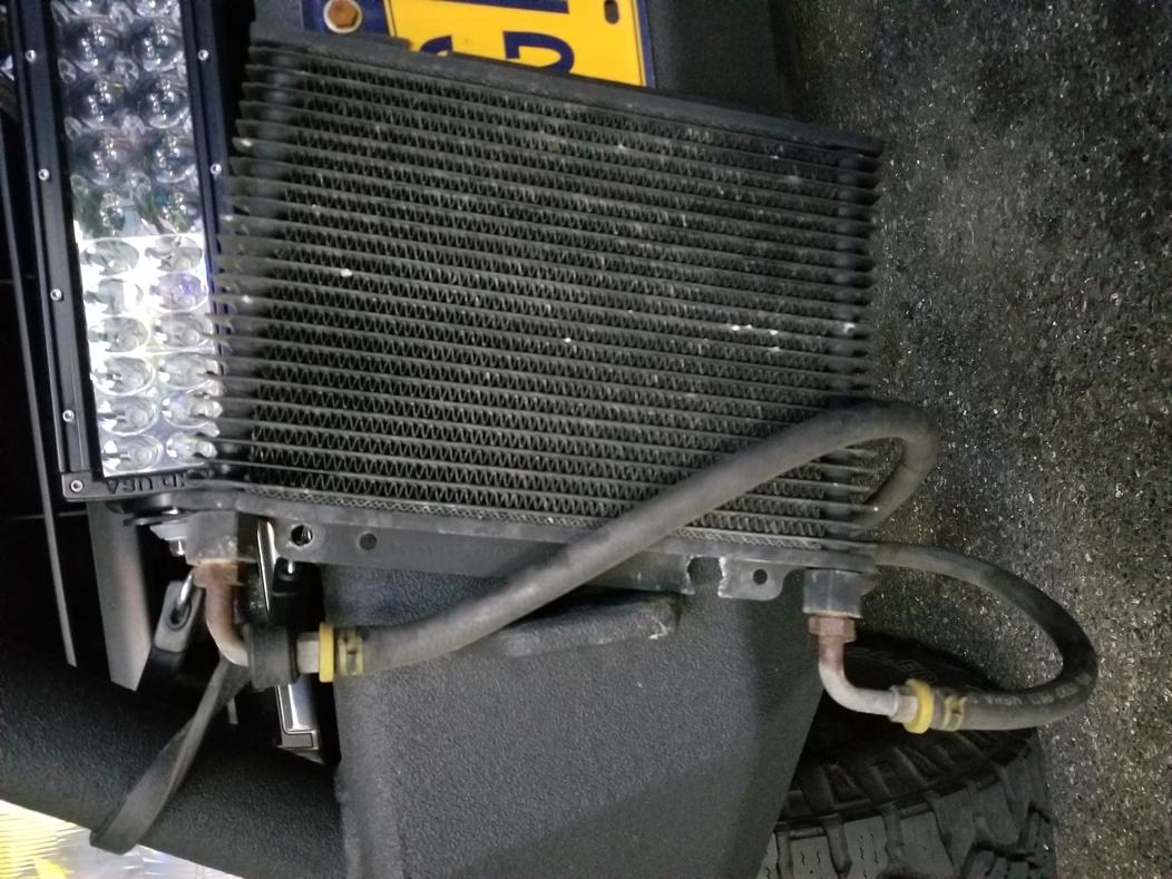

Like the Title says.... while driving the Cooler dropped to the road... I never heard it dragging... Guy in a Chevy pulled me over told me he saw the sparks.. No fluid leak.. Anyone recommend a top notch Cooler? any other upgrades?

I think it just rusted out- This was so i could get home. Damn photos are always sideways...

Yeah Id say if your cooler gave you 21 years if trouble-free service, and then survived being dragged under your truck long enough to save your transmission, you should find that exact model! Or hell, keep the ol guy around because he's apparently committed!
Called the dealer- They Can't find the PN in their system. Currently the one i have is still working with no leaks. I'm going to re mount it and carry on.

3rd gen 4runners didn't come with external transmission coolers. The original transmission cooling system used the bottom tank of the radiator.
That appears to be a B&M 70264 cooler.

Why? It looked like you just needed to remount it. If it was installed inline then you had a really nice setup.
That's what i thought too...
Upon further inspection when it hit the ground one of the connections cracked... not only did the port break it was bent too.so it managed to leak fluid.... it wasn't a lot.. thats why i thought it was ok..
