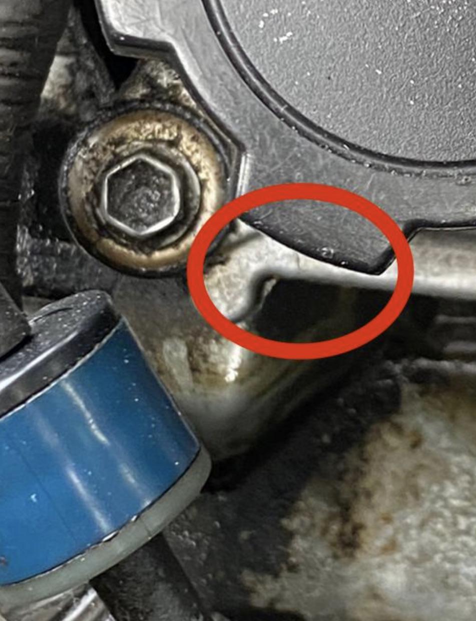

I still don't see it. Can you highlight it in paint and repost?
It sounds to me like your mechanic is grasping for straws here. There looks to be a lot of oil leaking from the opposite end of the valve cover from the oil fill cap. My money is still on valve cover gaskets/cam plugs. The person that did the valve cover gasket probably didn't do the half moons or cam plug correctly.
I just look at it myself and you can’t see in the picture but it starts right where the circle is also I think Is leaking from the back where cam housing plug is
I still don't see this valve cover crack you're talking about. To clarify I'm looking for a crack in the valve cover in the photos. Not a crack in the valve cover gasket.
The crack runs from the red circle to just above the bolt in the photo. Most of the crack is hidden by the oil cap.
