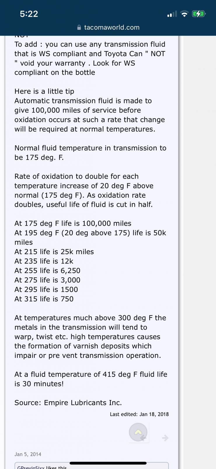

The attached screen shot has interesting information on this subject.

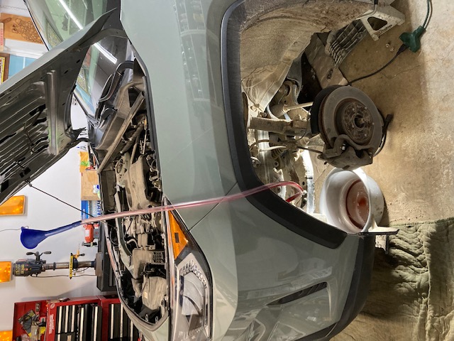

Refilling the transmission is easiest when you run a 1/2” ID clear hose from above the engine with a funnel attached. The hose is a snug fit for the refill hole and its easy to pour the atf vs pumping from below the truck.
The pic below is how I did our rav4, on the T4r you feed it down from under hood between exhaust and fender. Be careful it doesnt touch the exhaust pipe.
