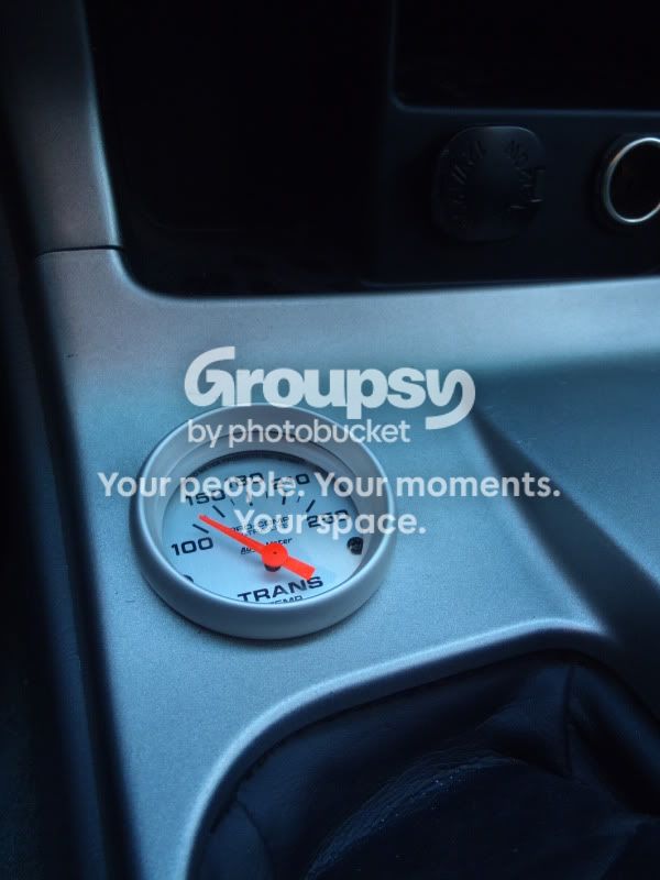

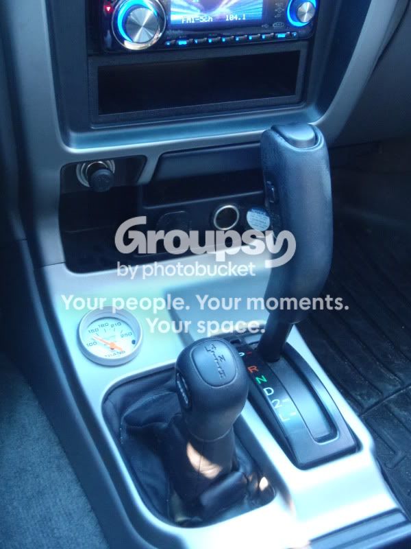

You're only option is going to be to install a conventional guage. You'll have to plumb the temperature sender into the transmission cooler send line, between the transmission and the inlet of the transmission cooler. There are lots of ways you could mount the gauge... A-pillar pod, steering column pod, custom. I went custom on mine and mounted it like this...

BigFish, clean install. I like it!
Yours is very nice and I think I will probably go with something similar. My console is a dark wood color, so I am going to look around for one that matches. By the way, how deep does yours go?

My mistake. I thought it was 2000+, but I went back and edited my post so the correct info is there for future readers. I just knew for sure that it didn't work on '98's. Thanks for the compliments on the install, but I can't take credit for the idea. As far as I know, this was first done my a member of YT who posts under the name "Mastacox". When I was doing my research on guages I saw his install and decided to go the same route.
Maxil,
If you install in this location, there is a limit to the depth of the gauge that you can use. My guage is an analog electric, and the mounting depth was about prob. 2.25" if I remember right, once you factor in the electrical connections on the back and the brace that holds the guage in place. You might check out digital electric guages... they might have a shallower mounting depth.
As it played out, I had to re-arrange some plugs and wiring under there to allow the guage to sink flush with the shifter trim.
