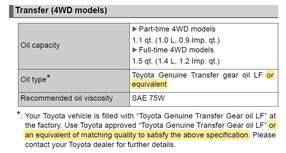

Transfer case fluid type for 2016 limited
Toyota Genuine Transfer gear oil LF or equivalent SAE 75w
1.1 / 1.5 U.S. quarts (part-time 4wd / full-time 4wd)
I used Mobil 1 75w-90 in my front and rear diffs AND transfer case. Like many on here. However, Toyota recommends their 75w and a lot of people stick with that to be safe.

As long as the fluid meets the requirements, any off the shelf gear oil will work.
