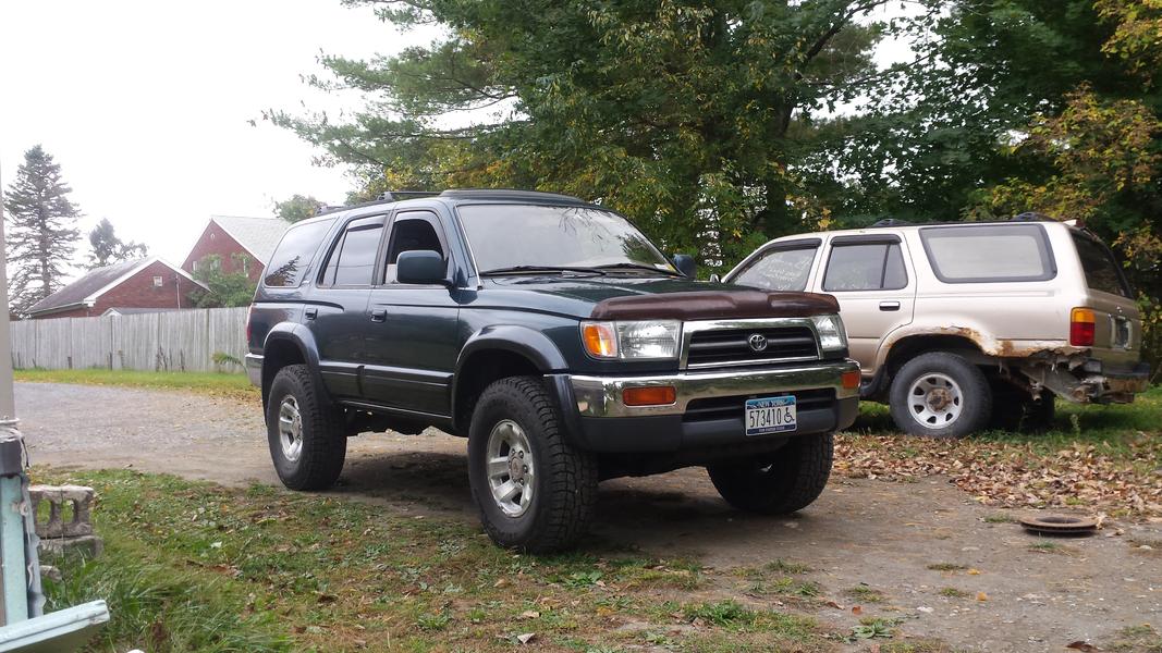

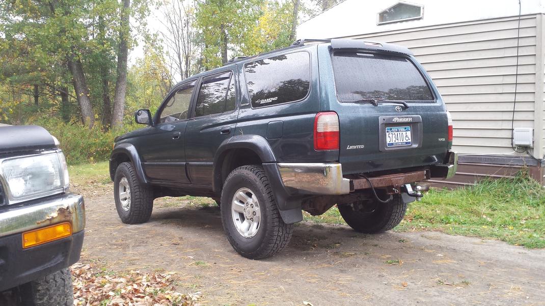

This is my rig so far. 98 limited elocker. Rancho quick lifts up front, spring spacers and lc shocks in the rear, diff drop, 99 center console upgrade, 99 headlights, spare tire hanger delete and tow hitch tuck.
Holy cow you guys get some rust up there!
