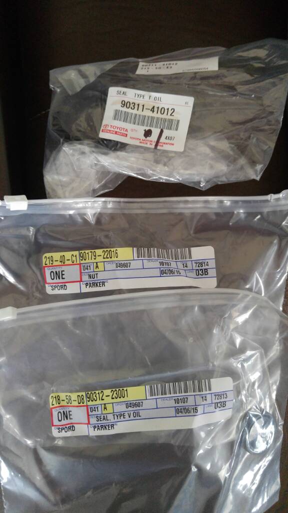

Here's the parts that I bought. 2 seals and a nut.
Couple quick notes for you...
The nut is a bear to get off even with air tools, or at least mine was, but better than paying over $300 for have a shop do the work.
Make sure to note the depth of your seal before removing it and you don't have to change the fluid, just top it off if it still looks good.

Took it to an independent shop where they verified it was the front output seal. They then quoted me $1,300 because they claimed that the tcase needed to be dropped and opened up. I was unpersuasive in convincing them otherwise. So it is going to another shop tomorrow where they quoted me $250 labor + parts because they read the actual Toyota repair manual for how to repair it.
I did the rear seal on my old Tacoma. It really wasn't that hard. Same design. It was easier than most any of the other things that I had to do to it.
The nut was staked to keep it from backing off. I took a cheap punch from harbor freight and ground some off of the tip into a small half-moon shape to where it would fit into the little gap where the nut was staked. Two or three taps with a hammer later it was unstaked and came right off.
