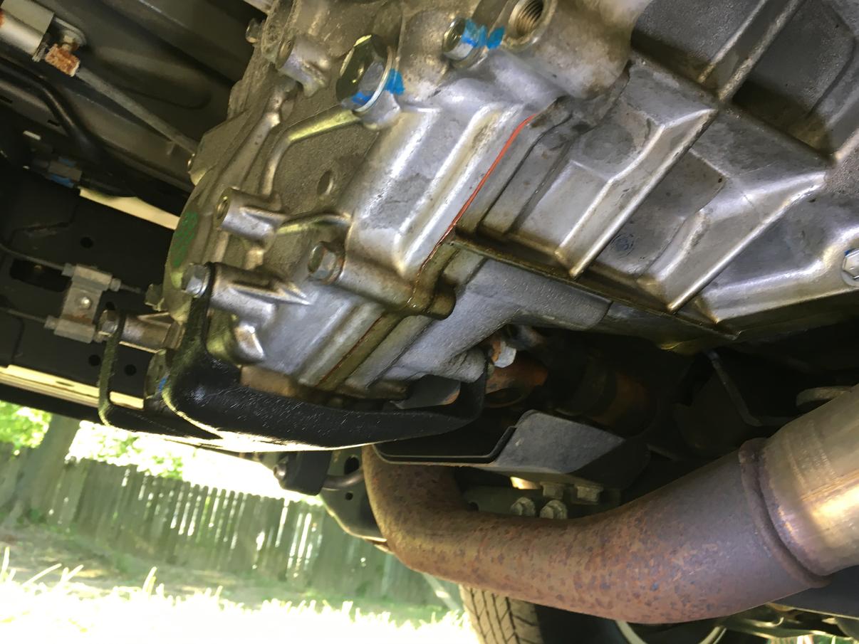

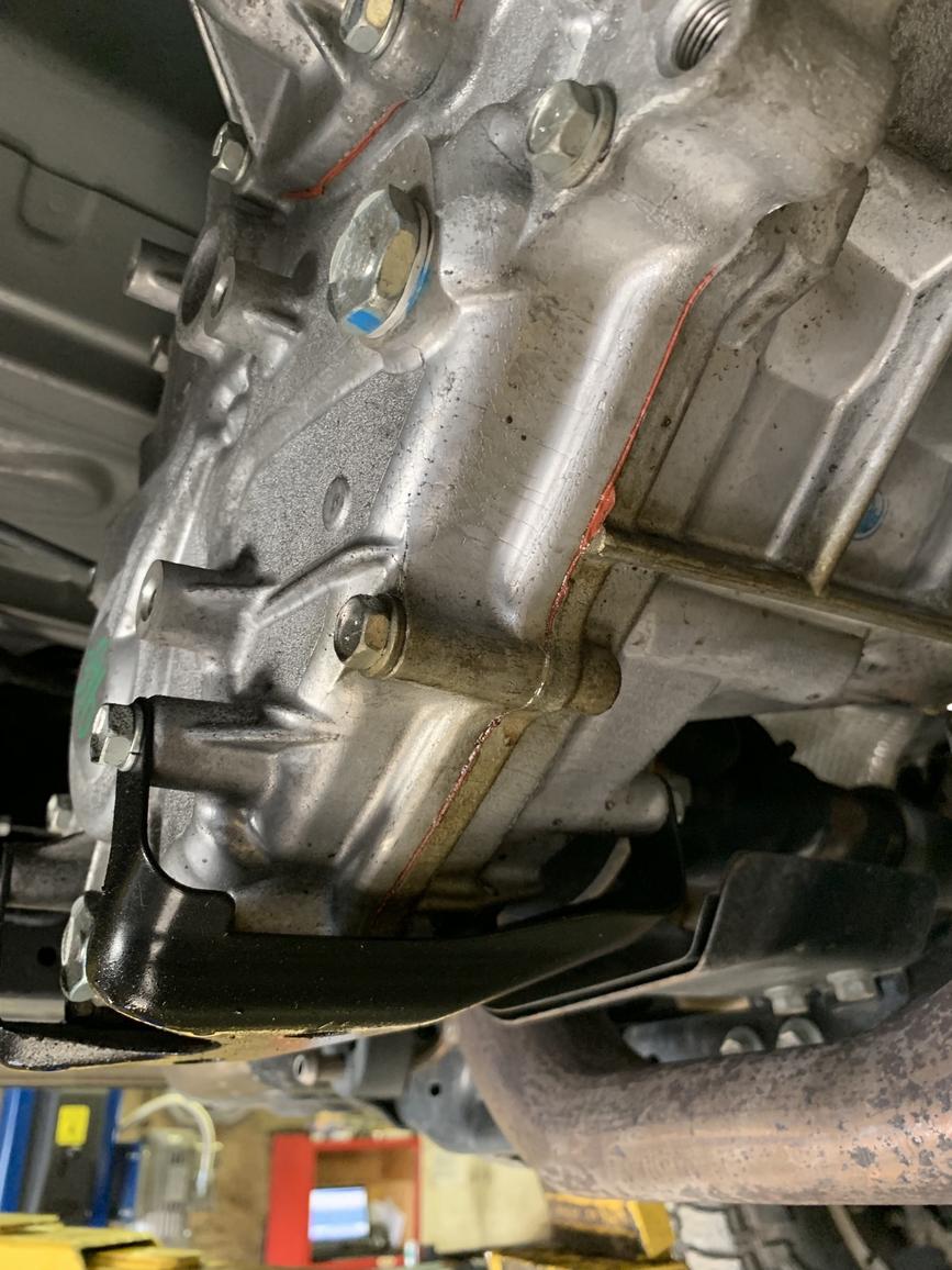

Has anyone else encountered leaking transfer case on a 5th gen? Odo just rolled past 36,000 miles, Toyota service said not to worry this falls under the powertrain warranty. I will have to schedule another visit for one of their master techs to rip it apart and take photos. As far I can tell the leak does not originate by the shaft seals.

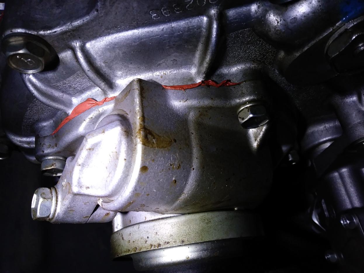

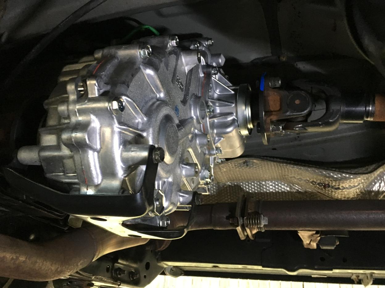

After two visits Toyota replaced the whole transfer case. First time they dropped it and changed some seals, few weeks later the oil started leaking again and this time the tech found some casting issue on the tranfer case housing. There were only two new units in the US, I had to wait few days to have one shipped from another state. Toyota (Don Joseph in Kent, Ohio) provided free loaners, it did not matter that I bought my 4runner from another dealership so the overall service experience was fine, they even washed my car before handing back the keys. Interior was a bit dusty though, I tried not to overthink why. Photo shows the new transfer case right after install.

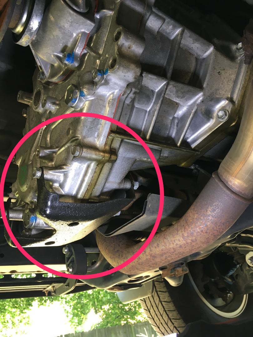

UPDATE 2: Second trip to dealership this weekend. Was still leaking from rear power output of transfer case, very slight leak. They had to order a new seal, and they're going to replace it. Taking them 3 days roughly for the repair. The reps at the dealership were incredulous -- could not believe I didn't wreck this myself somehow, or that I bought it new and already have a leaking tranny. Me too haha!
UPDATE 3: Truck has now been at the dealership (Toyota Marin) for a week. They ordered a new seal, pulled the transfer case apart, and then the new seal was no good for some reason. Tech is supposedly ordering a new seal to be delivered tomorrow, at which point they'll reassemble and be done with it. After reading the stories above about problems with casting on the transfer case itself, I'm not convinced this will actually solve the problem. Dealership says no service bulletin is out on this issue yet, but watch for more in coming months and years. The way the cars are built using highly controlled robotic processes, if there is 5 of these out there, then there are probably 1000 out there waiting to be discovered.

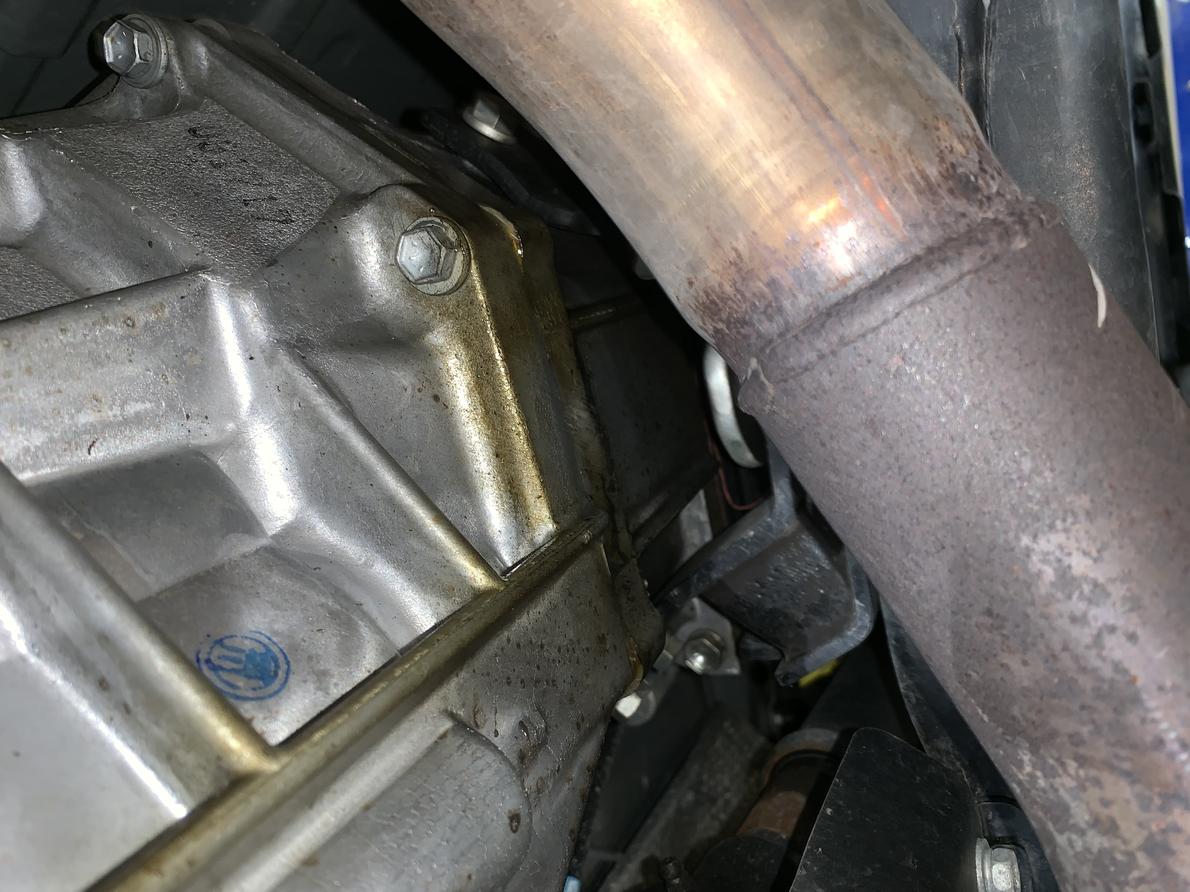

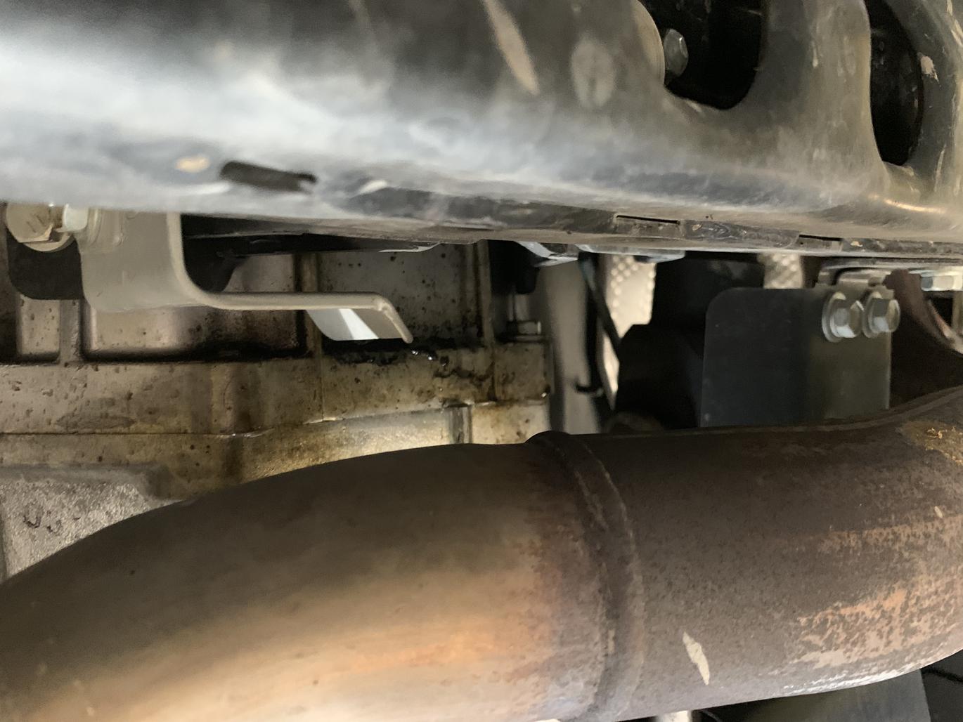

Bought this 2011 and completely missed this leak. Think it's leaking between the transmission and the TC. Anyone have any idea from the pictures?

Transfer case leak at front seal.
I posted this in another thread, but this may be a better location...
Rather than creating a new thread, I thought I would post here. I’ve read several transfer case leak threads. There are different issues I guess. Some have seals leak and others have the gasket/rtv leak between the two castings. I just noticed the leak recently. I just turned over 40k miles on my 16 TEP.
The dealership confirmed the leak and stated it was the front seal. They ordered the parts and I’ll take it in next week to have the work done. Here is my question. The tech said when the front seal is leaking, transfer case fluid can get into the transmission and he recommended a transmission fluid flush at >$400... I argued that if that happens because of a defective part covered under warranty, that should be covered too. I made no progress with the tech or service writer. I’ll save the bickering for when I return. Is that possible though? I would think there is a corresponding seal on the transmission. In order for the TC fluid to get into tranny, wouldn’t the tranny seal be leaking as well? Thoughts appreciated!
