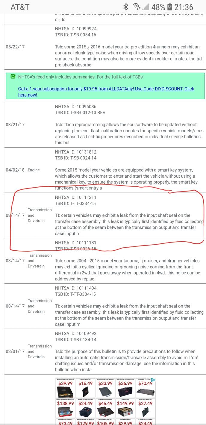

Transfer Case Leak
Leak may be related to a TSB I found.

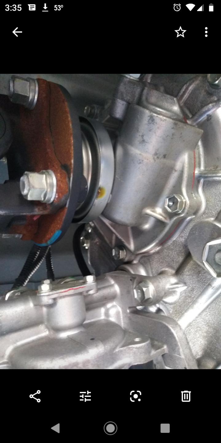

Possible t case leak on 2016
Hello all, this is my first post here. I came over from Tacoma world and a 2015 2nd gen Tacoma. I’ve been lurking, reading and learning a lot, and I finally have a reason to post. I recently purchased a new to me 2016 trd off-road with 18k miles on it on Monday. I haven’t even gotten the chance to really go over the truck yet. I did crawl under the the truck last night just checking things out and found a slight what looks like oil leak coming from one of the t case bolts. I’m still on the first tank of gas, haven’t used 4wd or anything yet... also should note that the truck was purchased from a Honda dealership, if that matters with warranty or anything. I know I at least have 6 months or 6k miles. But idk if this would be covered by Toyota at all. Figured I would just post here real quick since I found this thread and see what you all thought. Thanks..I do have a couple pics. Trying to figure out how to upload them
That 1 bolt almost looks to be loose; did you see if it was tight?
I haven’t gotten a chance to yet... I tried finding a torque specs diagram for the t case and all I could find was one for the 2nd gen Tacoma which looks like its only 8 ft lb. I’m assuming it’s going to be the same as that or close to it

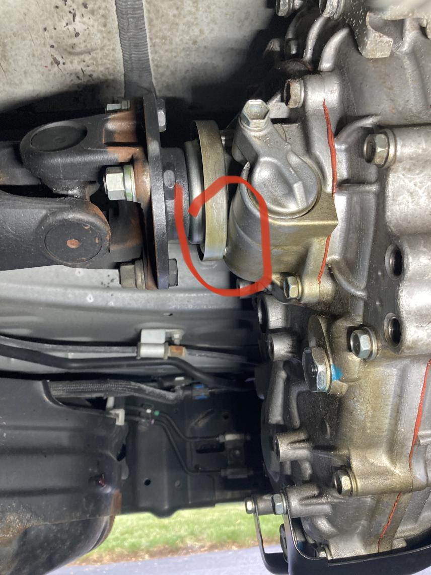

Just notified at 28k miles by the dealer of the leak. Def the seal because it’s coming around the aluminum ring. 2016 trail out of warranty so I’ll just monitor it
