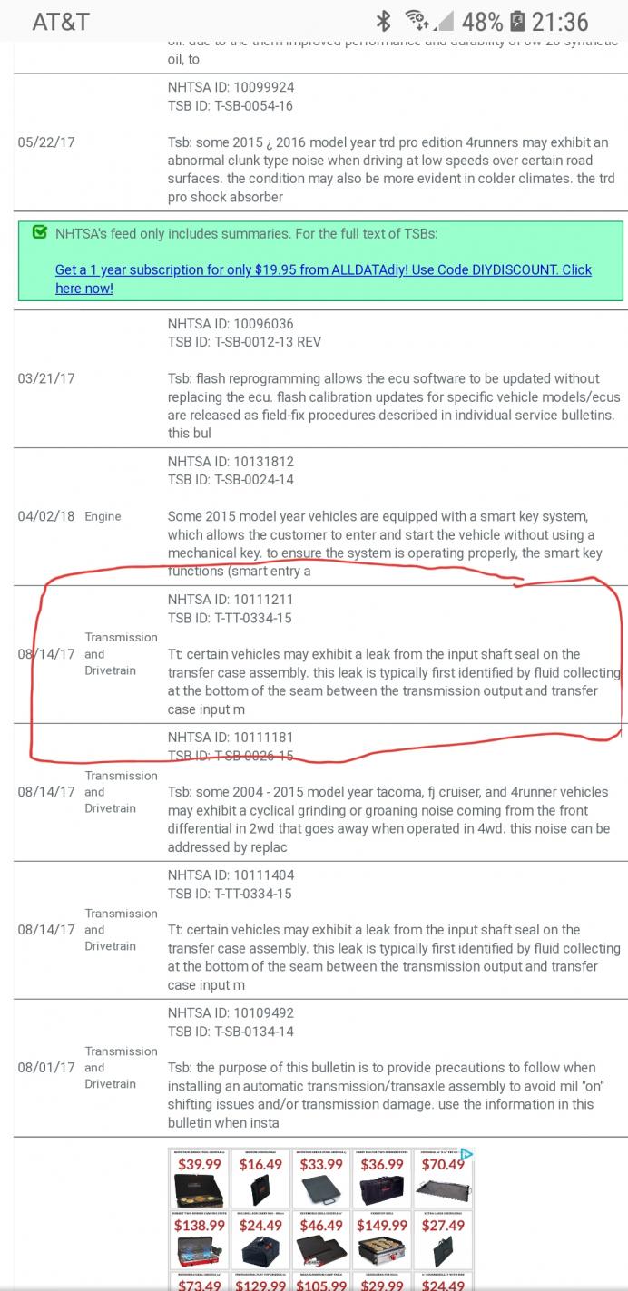

I believe there's a TSB on this possibly. I don't know where I saved it to, otherwise I'd post it. Nvm, found it.
