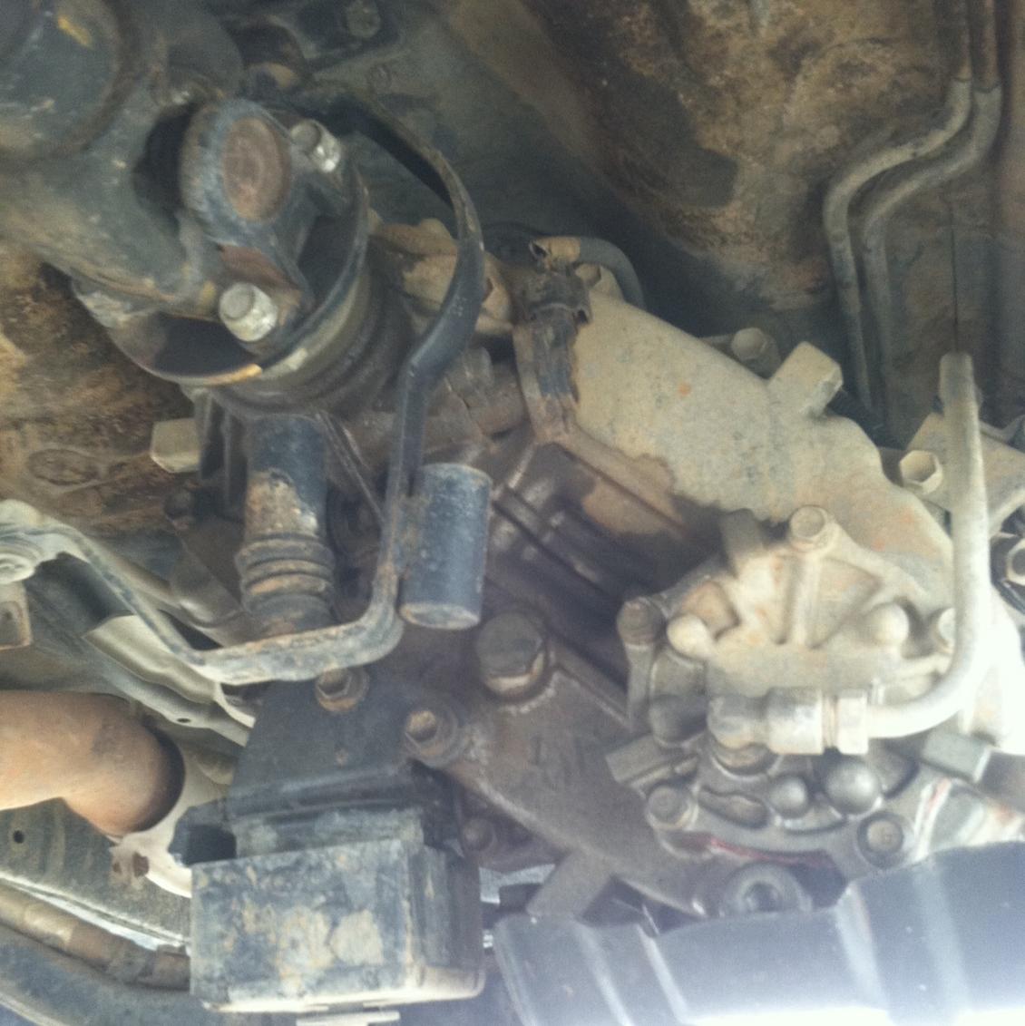

Yesterday I was driving down the free way and started getting a new grinding sound. Truck is a 3.0 auto R150f.
Symptoms: grinding sound when going at speed with foot off pedal, goes away once I get on the gas pedal. Sounds like a grinding clutch but a little softer
Slow fluid leak from back side of the t case where it mates up with the driveshaft.
With the truck on stands I'm neutral the sound is recreated and obviously coming from the tcase
I read on a couple of ranger forums that the symptoms are caused by the range/shifter forks being worn down. Just wondering if any of you guys agree or disagree, I will probably rebuild the whole thing just to be on the safe side. Or would it be better just to pull a used tcase that is in good condition?
I is confused? Is it an auto or 5spd? r150f is the manual gear box. If its the auto, the tranny and transfercase are joined and share fluid. If so....I'd drain the tcase and check for metal bits. If crap is in it....then drain the whole tranny system before losing both. Should be able to pick a used one up pretty cheap from a pick and pull.
If its a manual, i'd look for a replacement first. Then swap it out since the tcase and tranny are seperate. BTW, if its the manny, there's a guy here in austin selling the 5spd to gear driven tcase adapter pretty cheap. I'd go that route if you're replacing it anyways. Then its more reliable and it opens up all kinds of fun options.
Pic is a chain drive case. The chain could be slack and rubbing against the housing of the tcase. Id suspect that the chain might be stretched out and just too slack. Id drain it and check for metal shavings, if its rubbing against the case, it should have a ton of VERY fine shavings. If thats the case, id pull the case out and rebuild it or go to a gear Tcase using an adapter.
