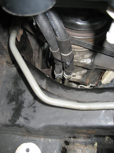

One question. I tried tracing the hoses from the cooler to the stock hard lines, but can't tell which goes where.
In this pic, which line goes to the top of the cooler and which goes to the bottom?

Zcruiser: this thread has the lines labeled, just follow the hard lines from the trans to see which is which... http://www.yotatech.com/f128/trd-transmission-cooler-3rd-gen-4runner-76336/
That's up to you and people will argue till they're blue in the face for both ways so good luck...
I put my line from the trans into the top of the cooler. If anyone thinks the bottom would be better, do it that way. This isn't even considering all the people who would say the cooler should be positioned with the inlet and outlet pointed up or down.
Yeah, I vaguely remember that discussion, and was thinking the consensus was that it should push in at the bottom so I guess it's pretty much right either way.
