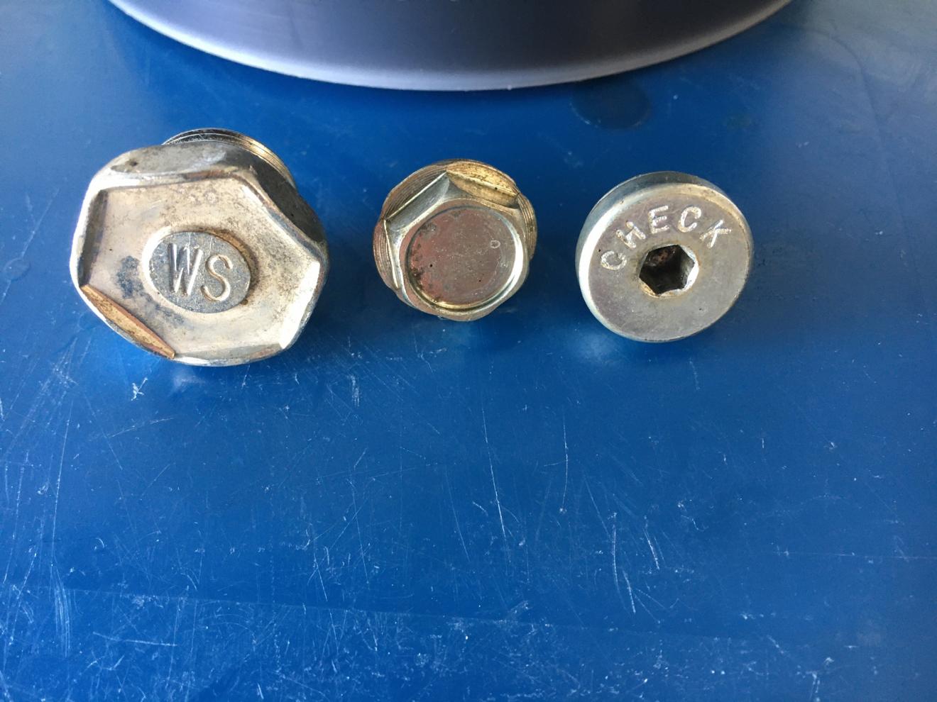

No. That's not it and neither is the one from the other thread. Those seems to be the check plug or drain plug.
The plug is very flat and it's body is hollow.
The oem plug has a WS on the head.

The ebay one is it but it's been sold and cannot find it anywhere.
It does have the WS on it.

Yup. That's it. The critter on the left along with it's o ring.

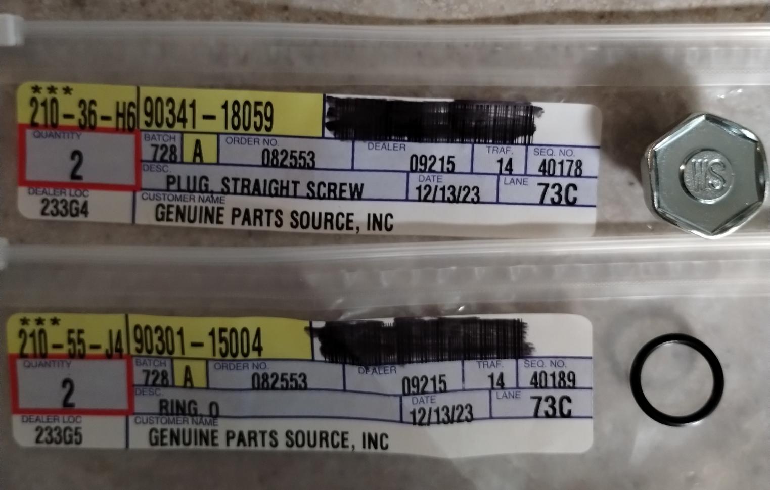

Ordered the plug 90341-18059 from Toyotapartsdeal.com and it was correct.
Just for future reference if anyone has to order a new fill plug on their website the first pic they have is wrong!
The first pic is the check plug and the second pic is the transmission fill plug with WS on it.
I rolled the dice and they sent the right one.
If y'all want an affordable scanner that reads the transmission temperature, I bought the Ancel fx2000 for $140ish.
Hope this helps.
Hope this helps.
