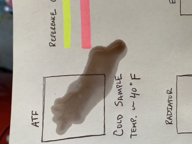

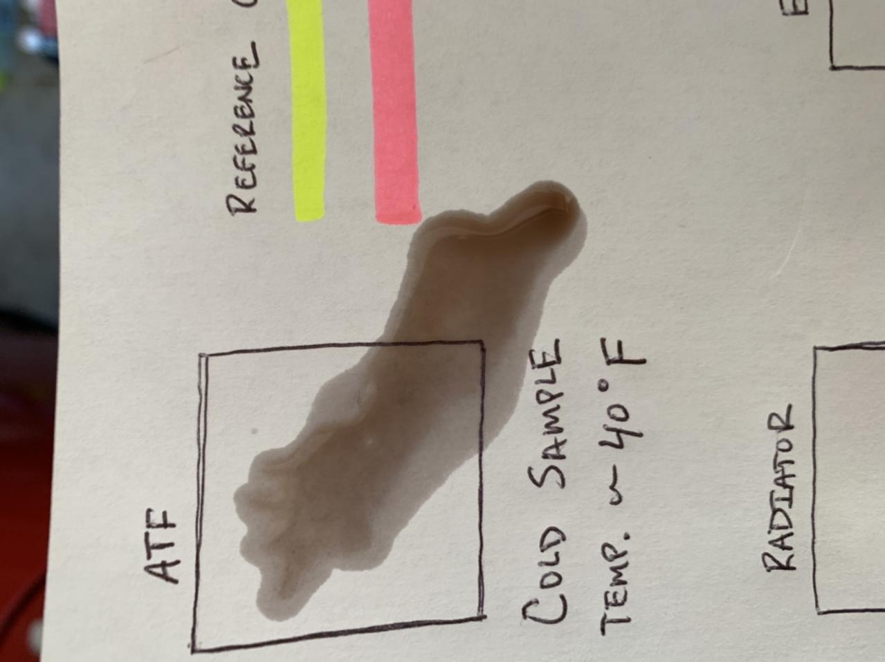

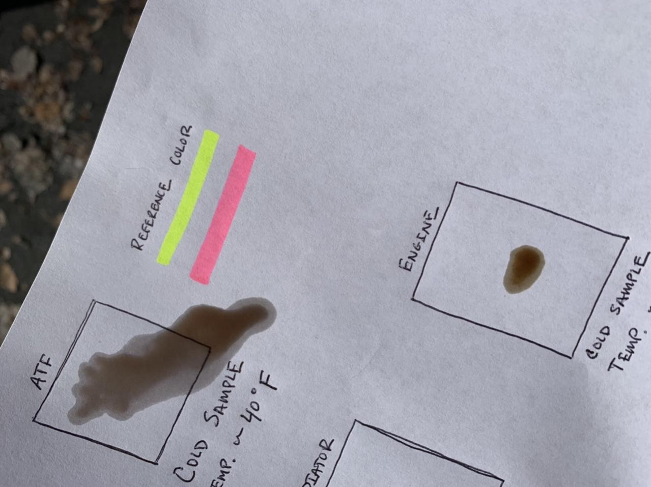

Ok, here are the results. See pics.
1. The fluid does NOT smell burnt
2. When putting the fluid between my fingers, it is completely smooth, like fresh motor oil. No texture.
Colors as shown in pics. The AT fluid is a reddish/gray.

This is coming from Honda knowledge, If you change the old worn out fluid (black, or dark brown), it starts slipping due to the old fluid holding up the transmission internals (just like the Toyota tech said). Honda Transmission are garbage, so thats that.
Looking at your pics, I say you should change it along with the filter - so pretty much do a full transmission service. Use the OEM Filter, and use a quality name brand ATF (Valvoline, OEM, ect.). It just looks to be way overdue. Dealers don't want to touch old ATF because they know they are taking a risk changing it since the transmission could start slipping (or in some cases, stop working all together) right after service.
Is your transmission slipping on any gear when driving normal?

Nope. No slipping at all. In fact it shifts like a new car—very smooth.
My lady was driving the truck when the light apparently came on. But it looks like after further questioning, the car might not have been on. She was still in ignition and thought the car was on. If you notice, when you’re in ignition and wait 2 seconds, the three lights that stay on are: AT Temp/Oil light/check engine.
I also have an obd and ran a scan. No fault codes.
So it looks like the AT light did not come on.
That said, my fluid is the color it is. Im thinking I may just wait to change it unless I have any issues.

I wouldn't hesitate to change it given the information you included. If you want to be more safer, I would start with a drain and fill - and see how the transmission goes after that. If nothing happens after that, I would drop the pan and change the filter as well. I have to do this to my rig soon as well.
I know about the light you said that turns on when you go ahead and crank the car.
These transmission are really good if they are taken care of. Even with neglect, they still shift well. I will admit that I do neglect my transmission, but I will service mine soon. Still shifts fine.
