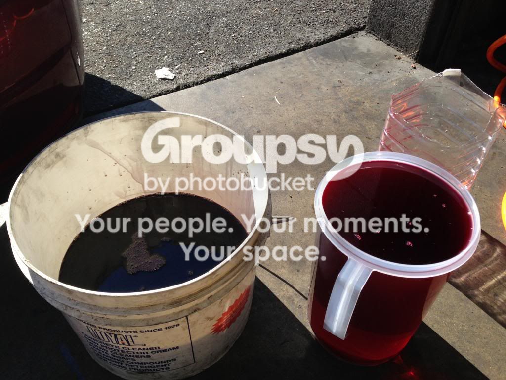

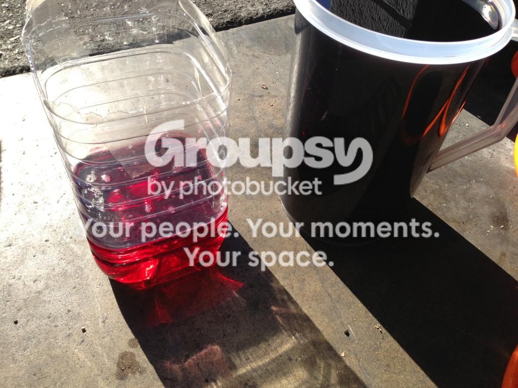

I decided to fully flush my transmission at 52k miles. Glad I did because the fluid did not look so great. I am the 2nd owner and when I bought the 4runner, it had a brake controlled installed in the car so wanted to change the fluid out ASAP. Wanted to do a full flush rather than a serial dilution.
I highly recommend people to fully flush their transmissions as these can go 200k+ miles easily when maintained well. I used 14-15 quarts of Toyota WS fluid.

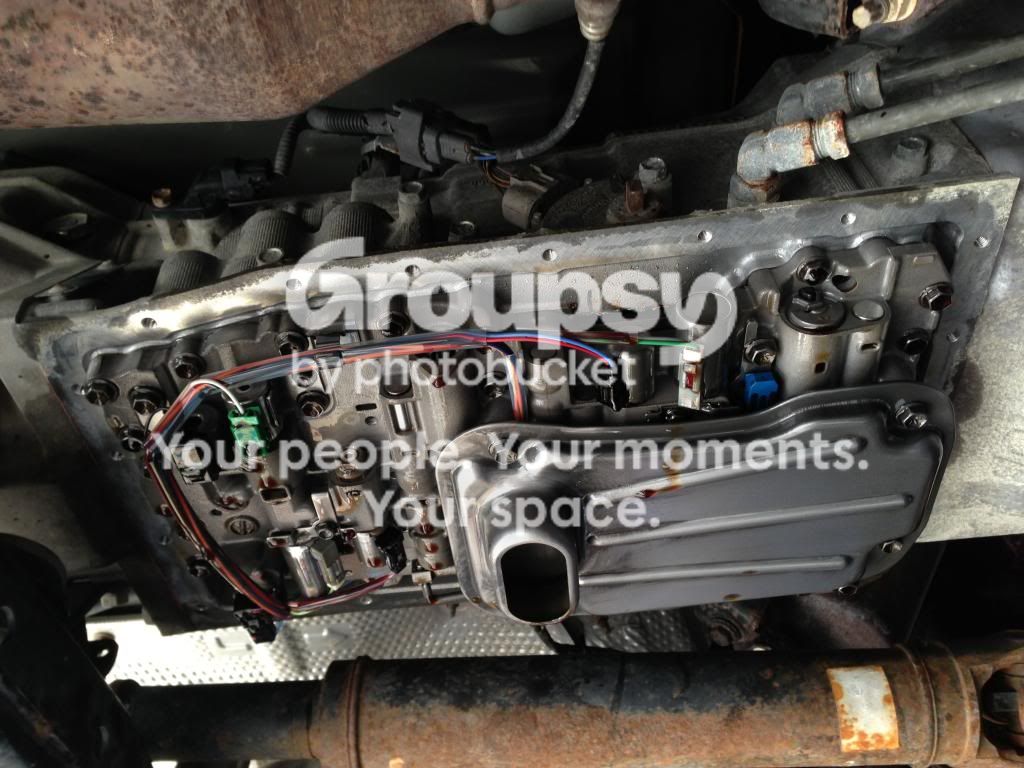

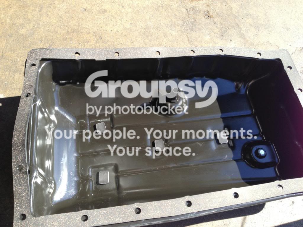

I even dropped the pan. Pan is very easy to remove so I cleaned up all the magnets on the bottom inside the pan. You can see the little magnets in the pics. They collect tiny metal debris. Magnets had a very very small coating of film on them. This means transmission is healthy.
To flush the transmission I removed the return line that goes to the radiator. Started engine, let it run for 15 seconds or so to get out 2.5-3 quarts. Stopped engine, put in the same amount of fresh WS fluid into the transmission that came out. Repeated this 3-4 times until clean fluid was seen.
Then I entered the transmission temperature check mode to properly check the fluid. This is the trickiest part for me since the instructions off the Tacoma forum did not work with my 2009 model year 4runner. So I paid the $10 bucks to get it from the Toyota TIS site. After that worked great.
Transmission performs flawlessly . Smooth shifts. Will be repeating this once more in 2 years or so.

I just wiped everything down with a cloth including the magnets inside, and put back the magnets in there original position in the groves of the pan. Then I sprayed the pan with some brake fluid that evaporates quickly so I don't have any oily residue when installing the new gasket.
