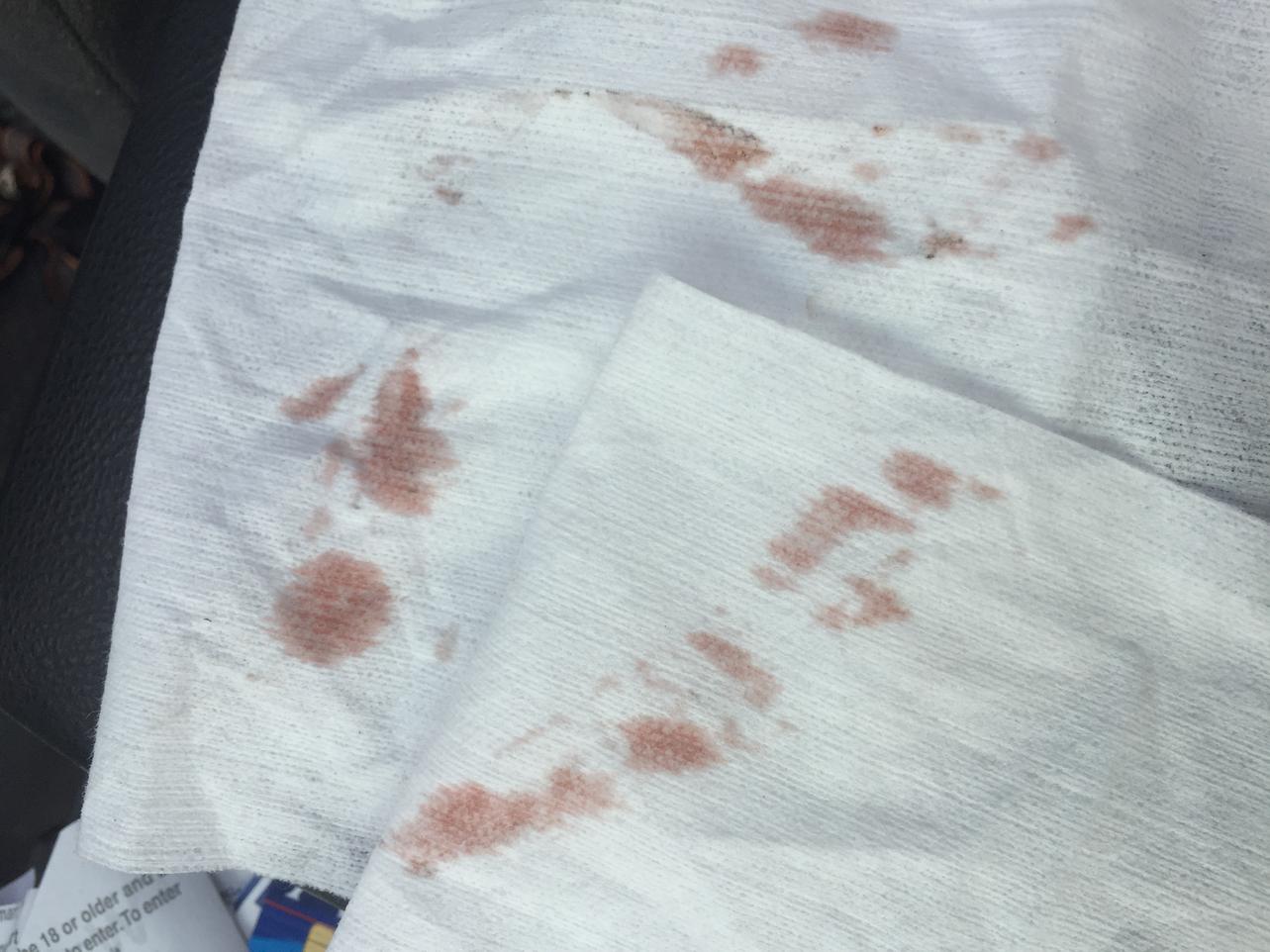

Basics first, how many miles on the vehicle and how many miles on the current fluid? Have you checked the fluid level? Yours is an '03, so it should have a dipstick which makes this easier...get it up to operating temperature, park on level surface, leave the engine running and pull the stick, wipe-reinsert-remove-read.
Use a white rag or paper towel when you wipe the dipstick and post a pic of the fluid color on the rag. Red = good, orange = generally OK, brown/black = bad.

Welp it here it is...also fluid levels are good to what I could see

That looks like the fluid is in good condition, likely the prior owner had it flushed or otherwise serviced. If you've had it for over 40K miles, you have a good feel for normal behavior and the symptoms you're describing are a change from what you've been experiencing.
It's possible that the transmission downshift is a symptom, rather than the problem itself. My previous Tundra 4.7L V8 started hesitating under acceleration at around 120K miles, I paid the dealer to clean the throttle body and all was back to normal. Similar behavior to what you're describing, e.g. passing at highway speeds, throttle felt unresponsive and then woke up.
