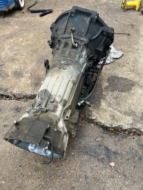

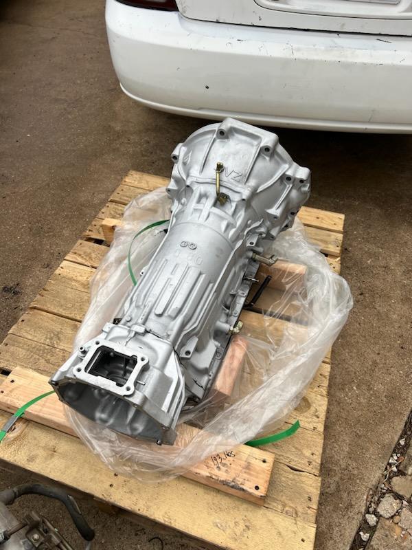

One thing to look out for is the rear of your transmission. Though I gave them my VIN to ensure a 100% match (and they said it was) there was a cover plate missing on the new trans - my old one does not have one so we made one for it . See attached pics of old and new trans for reference. To Yotas credit they did send the cover plate out yet we had already fabricated one. No big deal yet you can double check in advance to avoid this small install slow down.

They found one - had to pass up a couple they said due to extra poor condition - glad they are choosey.
It matched except for that cover plate on rear - my '01 doesn't have a cover there but the one they sent did and they did not include the cover thinking I had the one from mine. Just made one - nbd.
It works flawlessly and improved mpgs a solid 2! (even though I did not feel any slipping and shifts seemed firm enough on old one).

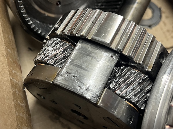

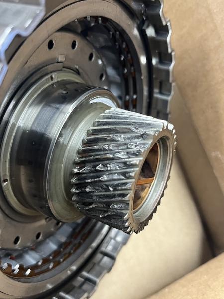

Well Im back home with my new transmission. Its what I assumed and the planet gears were shot. Drove 7 hours to Yota1 for the install. They ran into a little issue and it took me 2 days for the swap but its been working good.
